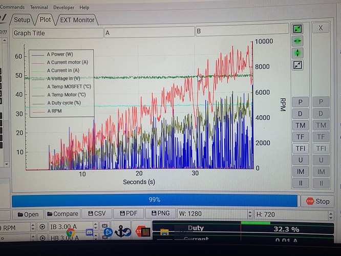

tried testing on a downhill to see? since techniclly speed is not going to be a limit if it becomes one you might have an actual speed limit set. without knowing.

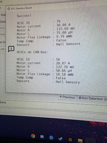

Honestly looking at those motors, and the extreme low amps that it resulted in … 30… (mine are landing 77-89amps per motor on the tool.)
Im not surpised by your speeds.
Sounds like a 450-500w (1500W) MAX motor. (not the true measurement) vs things like those 1650W (3500W) max motors
