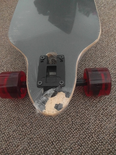

, First of all I started by purshasing a longboard from eBay ( I know big mistake) but I thought…well I don’t know how to skate I’m gonna crash quite a bit so there’s no point investing so much in s good longboard, so I purchased this one , but eventually it came like this and I got refunded , and so I tried and ride for a bit , but after reading a bit I knew I needed something a bit better, so I purchased this beautiful deck for 90 pound, I got some sabre trucks, bons red bearings and some Chinese flywheels 97mm (Shi** color but AliExpress problem as usual) I got the lipos 4x 5s 5000mah 30c -40c I managed to build the anti spark switch with a huge help from Justin , he is restless ! I got a Chinese remote already remove some parts I’m still unsure about using a belt or chain , still having a problem with spacers , the enclosure I was thinking about using a seed tray In the beginning I was thinking about using 18650 I got 50 of them but the problem is the amp draw, even 10s5p is just 50amps which is just to little for dual motor setup so I choose the lipos (2x5000mah in series can draw within the limits 150a which is more than i’m ever going to use , Now is just a matter of waiting for the motors 6355 190v from torqueboards , aswell from theirs 12esc 150A continuous ( still held in costums ), I avoid the vesc due to the configurations , I know was better to customise but I don’t want to bother, so I hope you enjoy this part list and I’ll keep updating things also whenever i have time i need to train my inexisting skating skills …will be fun… cheersonce again i wanna thanks to JdogAwesome because after like 10 messages bothering him about the anti spark schematic i did manage to understand things a bit more i din’t had a pcb so i just soldered the parts together and tomorow i’ll test everything ! fingers crossed !
