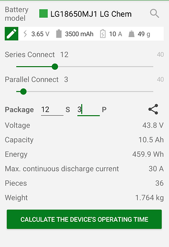

So I did the test and i guess it works if you know the AH and limit the battery amps safely.
I’ll just set to 9.0 aH. I bet they kept it the same specs. Maybe it’s technically 9.6, but as long as it doesn’t damage components I don’t really care.

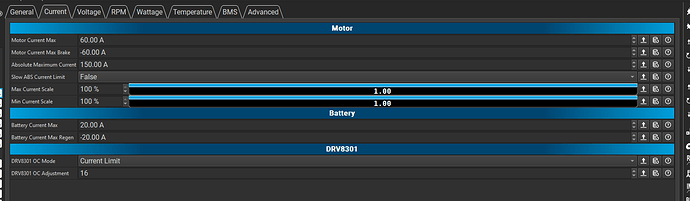

Do you know of any good resources that explains “Motor Max Current”, “Motor Current Max Brake”, “Absolute Maximum Current”, etc. Basically everything on the “Motor Settings/Current” tab. I’d like to have a good understanding in stead of having to ask.

I had this set to 23A per motor for last config. How high you think I can put max amperage at?
60A if they’re 5055 motors. These are each side.
+80 if they’re 6374.
40A for hubs.
But battery, since you don’t know what it is, put 20A for safety each side. The regen can be the same or less if the brakes are too strong.

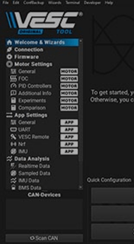

Put 20A -20Afor battery. If you look at the bottom left, you’ll see a “local” and “can” square. You need to do the same on the other end.
The motor brake can go higher, matching the motor max, but its up to you.
This little square.

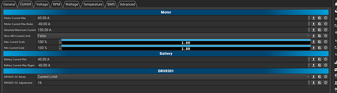

If done, they both should be 60A, -40A or more and 20A -20A both side.
Yes. Write to both after changing. Afterwards, have a test ride.
Success!!!

Onsra got back to me. These are “LGMJ1 18650 3500mah”.
So I changed the amp hours on each VESC motor config to 10.5aH. That’s a nice little range boost.
I noticed I didn’t run the motor config on the other “vesc” or canbus. Would this cause damage to any components if the motors had different configs?
Also, what can I change the “battery current max” and “battery current max regen” to in terms of max amps?
Yes. Do make sure both sides of the esc are the same. You don’t one to blow up, costing you $250. You can easily do it on one side by using this box in vesc tool:
