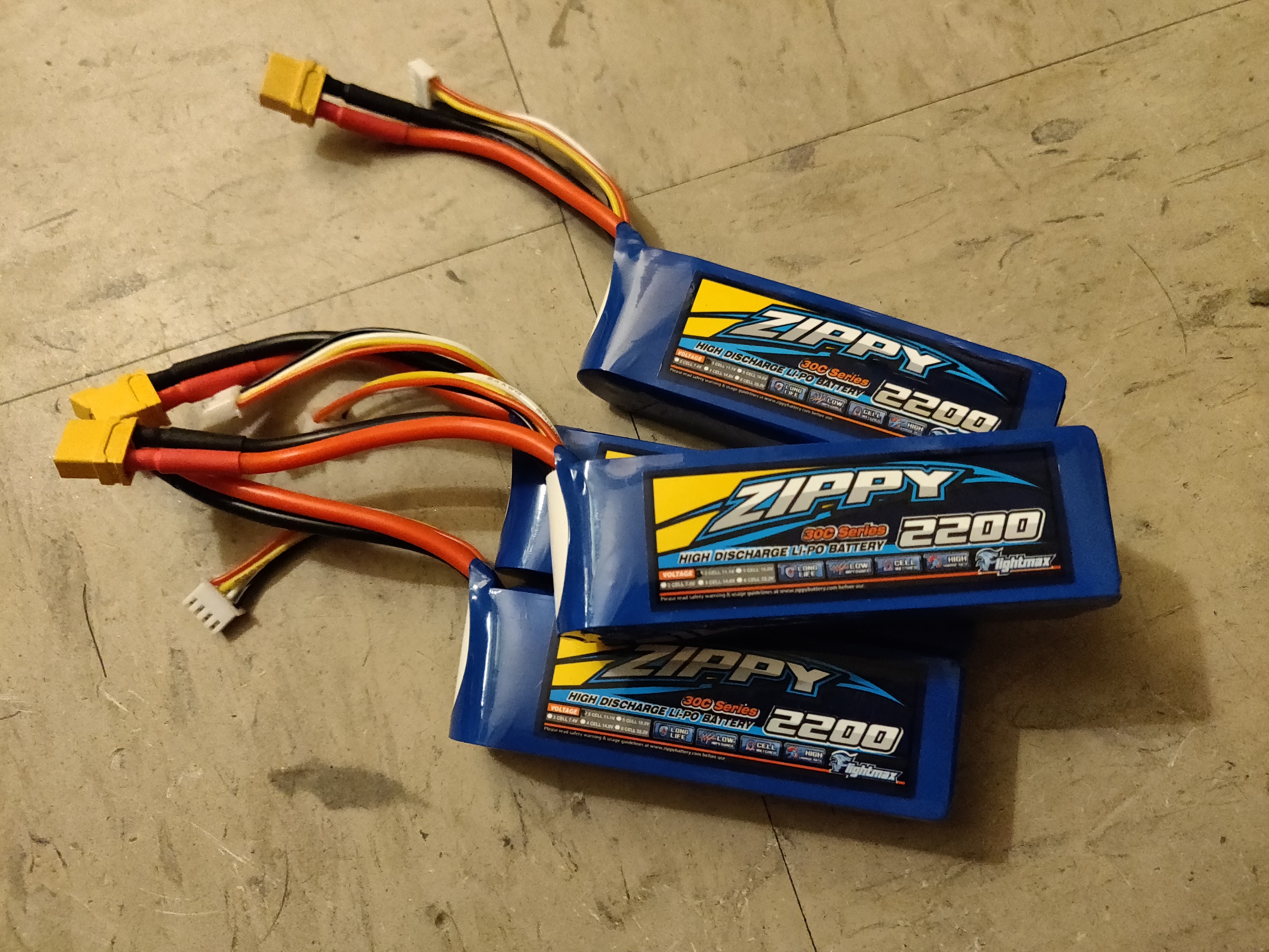

I have 4 zippy 2200mah 30c 3s flighmax that I would like to use in parallel, and I know I can just use 3 xt 60 harnesses (1xt 60 to 2 xt60 to make one for 4 lipos but that just seems sketchy)
Making them in to a 12s1p or 8s2p
uh, i said paralell…
so it would become 8800mah 3s 120c lipo
So 4x 3s lipos in paralell?
Yep…
i think the @aulakiria spot welder should get real strong welds with 120c
