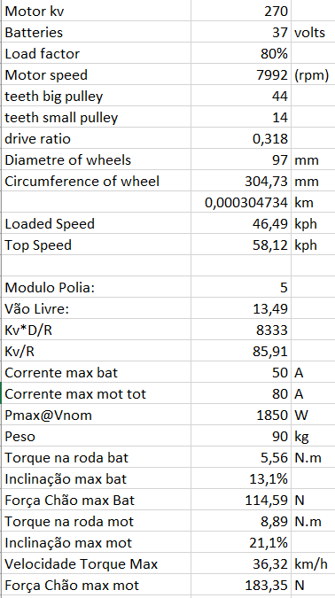

Calc.esk8.it
I wont be changing my motors for a long time I need to upgrade other parts first. I dont even have vescs yet. I currently use the eBay ESC which has been doing very well for me. aswel. someone told me to limit the ERPM to around 55k and in real world test I probably wont even reach that only if you use full throttle with wheels in the air
What’s your wheel size? And 10S right? I have a spread sheet that is simple to understand. 4:1 is hard to do since you have low clearence and/or low teeth in mesh on the motor pulley

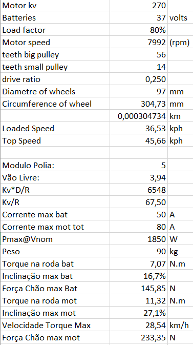

Put in please 97mm wheel size, 10s and im not sure for gearing ratio. according to this calculator http://calc.esk8.today/ 1:4 give me a top speed of 45km/h which I wont get close to. preferably I would like a 1:5(to give me 36km/h top speed) but then as you say I would have little teeth on the wheel pulley. maybe I could add a idler pulley?
Then again for a 1:5 ratio I would need a 60t pulley
The problem is not even teeth in mesh, this you solve with an idler as you said, but lower than 14T the diameter of the pulley is too small, the belt in bent more than it should and it will last a lot less
Here’s 1:4, looks good, top speed wise is the same gearing I use on my board, BUT the pulley sits a 4mm from the ground, even less if you consider belt thickness, unless where you live the road is pristine and no little rocks exist, you can’t use that
With 1:5 the wheel pulley would be bigger than the wheel
The best you can do with these motors is 1:3,14
You can’t really go bigger than 48 tooth on 97mm wheel with M5 pitch belts. The pulley is just too low to the ground. 48 is already kinda bad.
If you switch to M3 pitch belts then you can get a better ratio, but that introduces other problems. Almost no one uses M3 pitch.
Also to your main question, 25a per vesc should be enough torque for hill climbing with the right ratio and considering your not that heavy / not a top speed addict.
