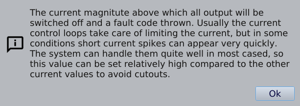

Abs max is for the fet side. Nothing to do with the battery amps. It’s to prevent damage to the fets if the motor current spikes.

It’s in case there is a short, or you hit the gas but the motor is in magnetic lock from no sensors or high enough bemf and the current spikes, and the motor squeels.
For the battery it is just DRV_OVER_CURRENT both in and out, and the control is shut down for a moment and resumes. Motor side is abs_over_current at least from what I’ve seen, abs_over_currents are full shutdown of the DRV causing the MCU to reboot.

VESC tool help:
Do not change it. The spikes happen all the time and are largely independent of the battery current (can happen between capacitor and motors). With 65 A you’d get constant cutouts of acceleration and braking, which might throw you off your board. It is not about your battery or motor current, it is about what the VESC can handle for a few microseconds before it notices and shuts down. 130 is high enough to not happen during normal operation and low enough to not damage your VESC.
