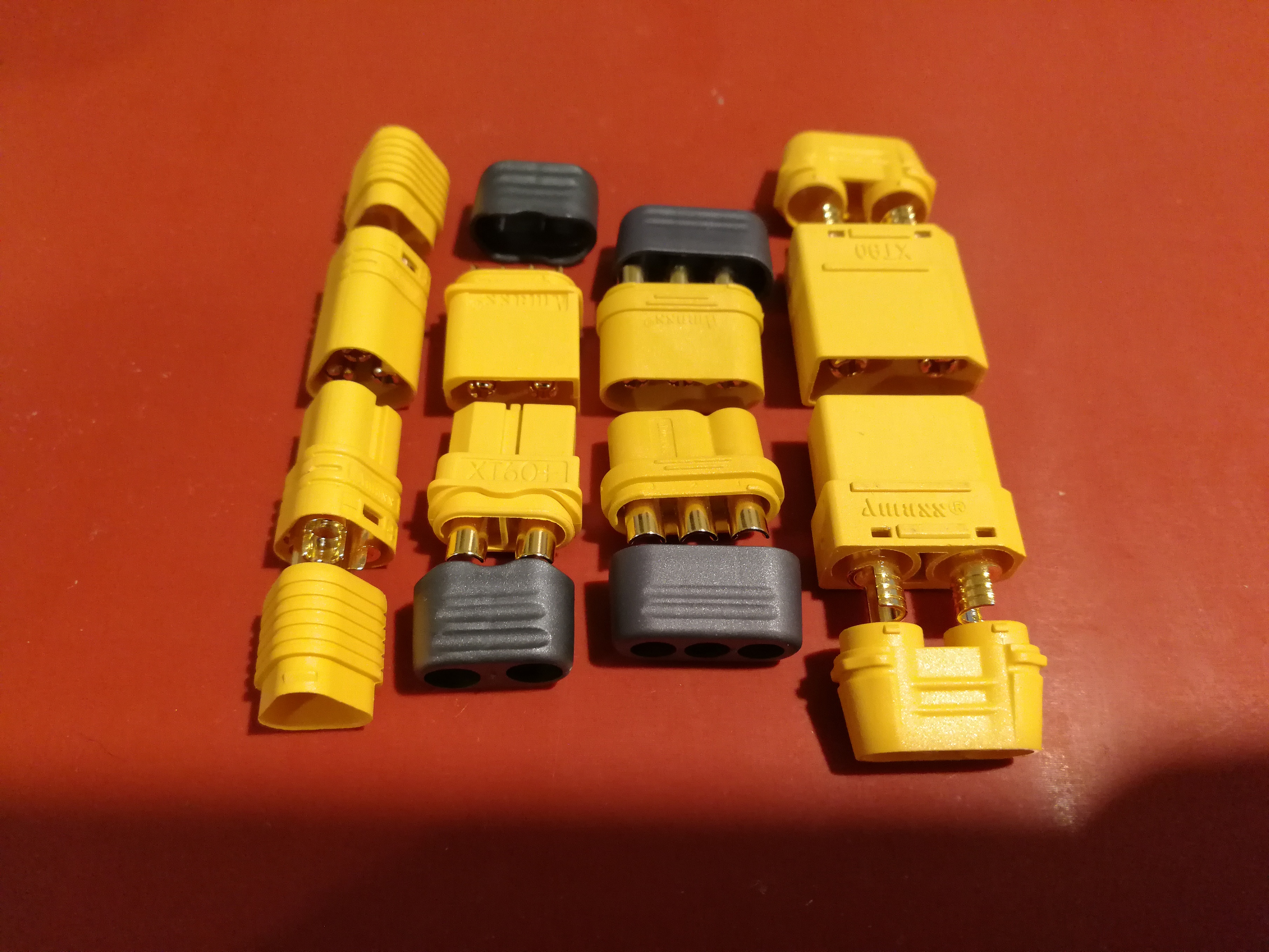

If you want to know they are real. The pins should not melt out of place when soldering the wires/means they are made from nylon instead of some cheap plastic.
Got the MR60’s in. The plastic is solid and the connectors seem high quality, as good as any other genuine amass. I’ll be putting them in a build this week and I’ll report if I have any issue with them.
I like those for phase wires, it also keeps them in the same orientation so if you disconnect the motors from the ESC you don’t have to go through a motor detections again.
looks like some kind of audio headphone connector mmcx but would need many more wires than that for hall sensor wires so not sure! Aren’t the MR60 only 30amp? How does that work out for an electric skateboard as thought they can pull more amps than that. I Guess answer is they exceed that only in short bursts.
