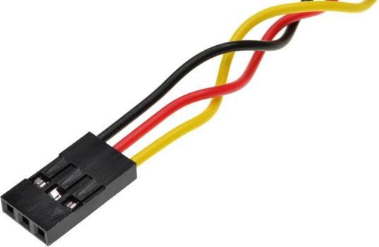

Is JST micro the same thing as JST PH? I need to connect ESCape to mini remote receiver and this is only thing that I found. https://abc-rc.pl/przewod-arduino-2-54-na-micro-jst-3-pin-30cm?gclid=EAIaIQobChMI373Rgd3B3QIViNKyCh1U_gHhEAYYAiABEgI2OfD_BwE
No, the jst part looks different eg. smaller then regular JST-PH. On my ESCapes i cut a normal 6 pin JST-PH in half and soldered it on the other end of the plug which goes into the reciever.
