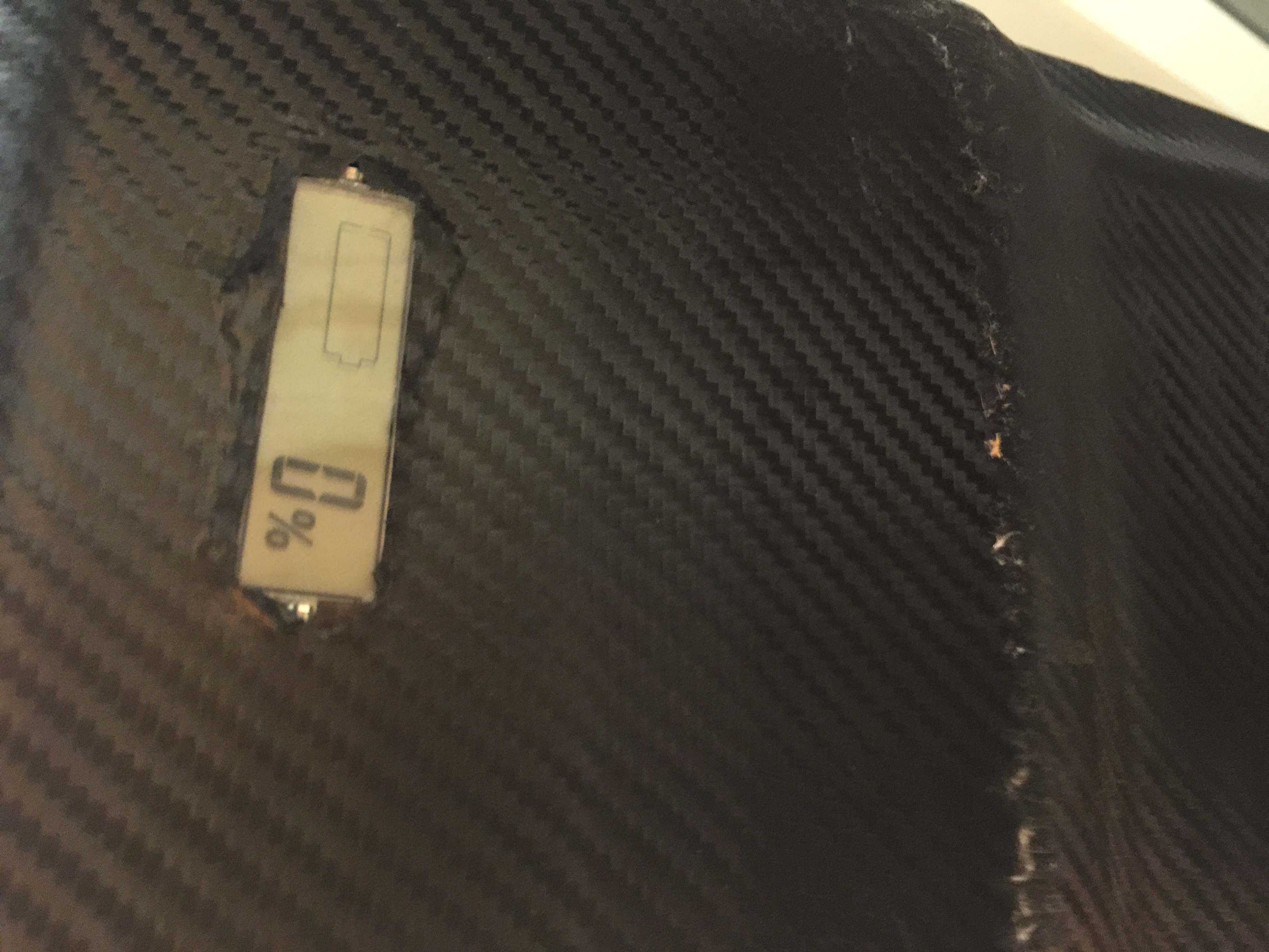

The voltage read out actually turns on however it shows 0% and no green backlighting.

In the following pictures I have the voltage read out coming off the xt90 showing 31.6v and the voltage readout showing 0%.
