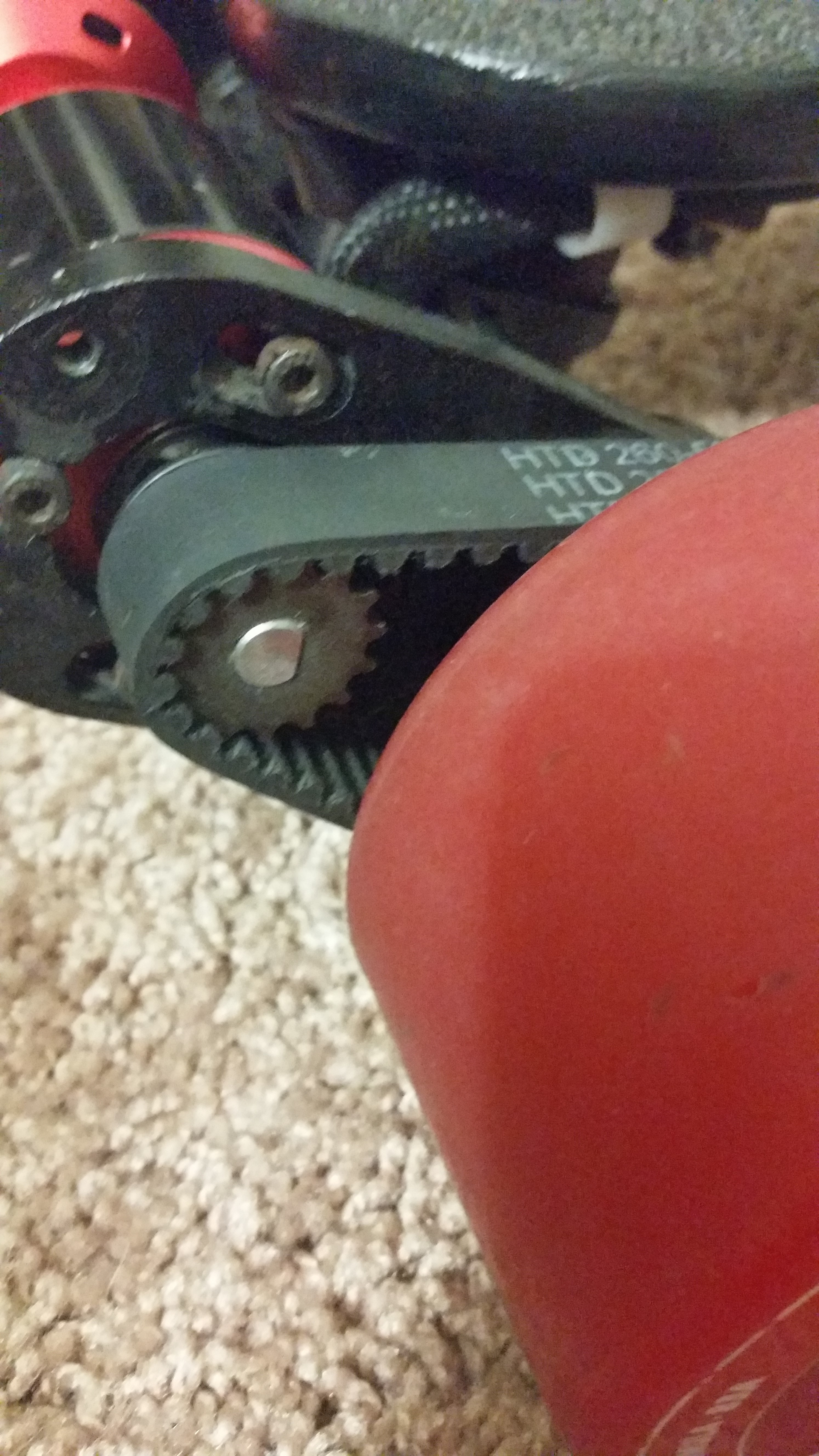

Alright sorry for the late follow up I was on vacation. Anyway I found out something interesting about the evolve trucks and the kegel gear. If you use a washer for inside wheel wheel bearing it will prevent the gear from sitting all the way in the wheel and cause the belt issue I was having. Check the photos to understand better. Soon as I removed the washer I’ve had no issues.
Without washer
With washer
You can see the wheel washer stops before the wall of the gear touches the wheel
