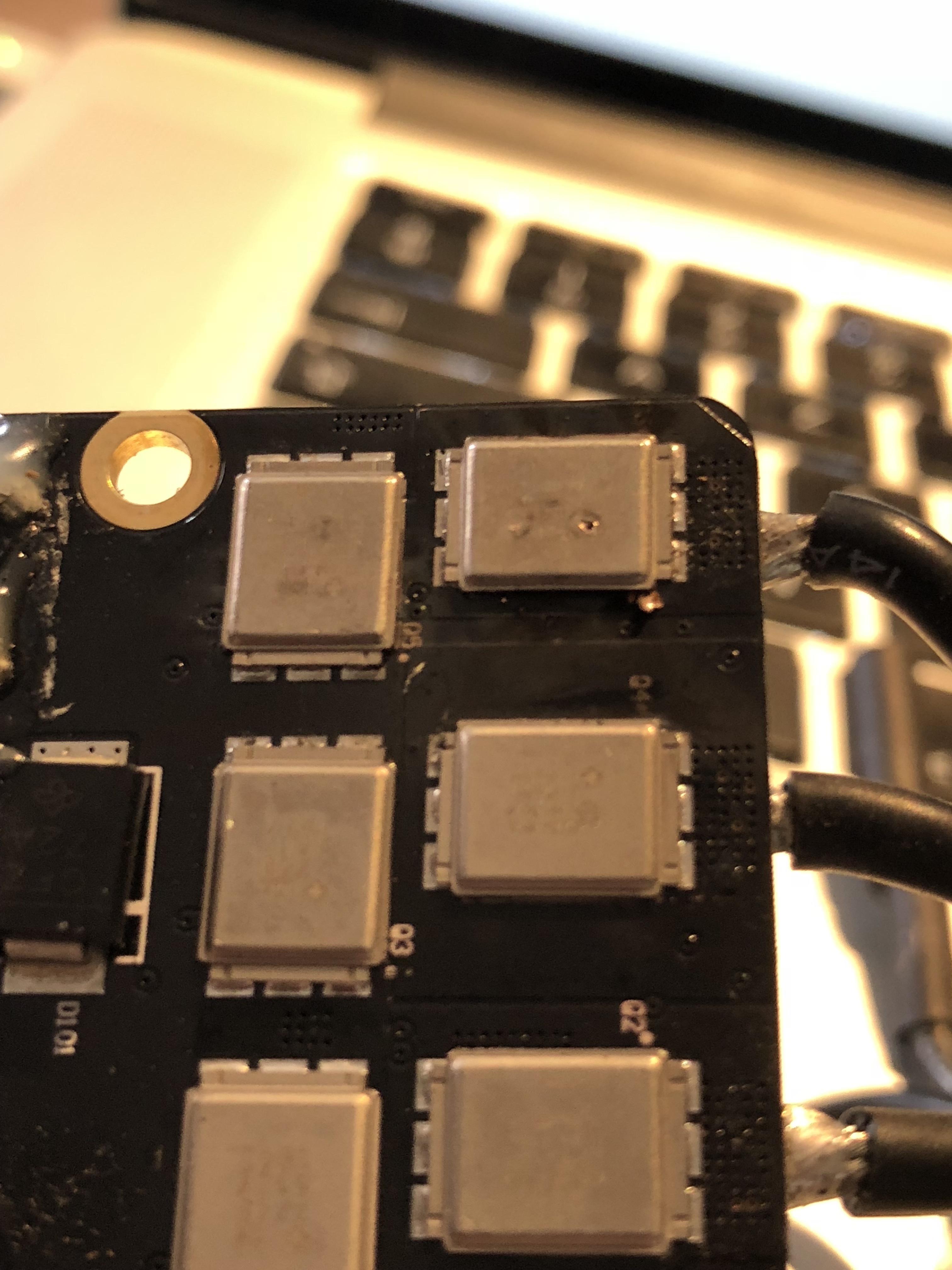

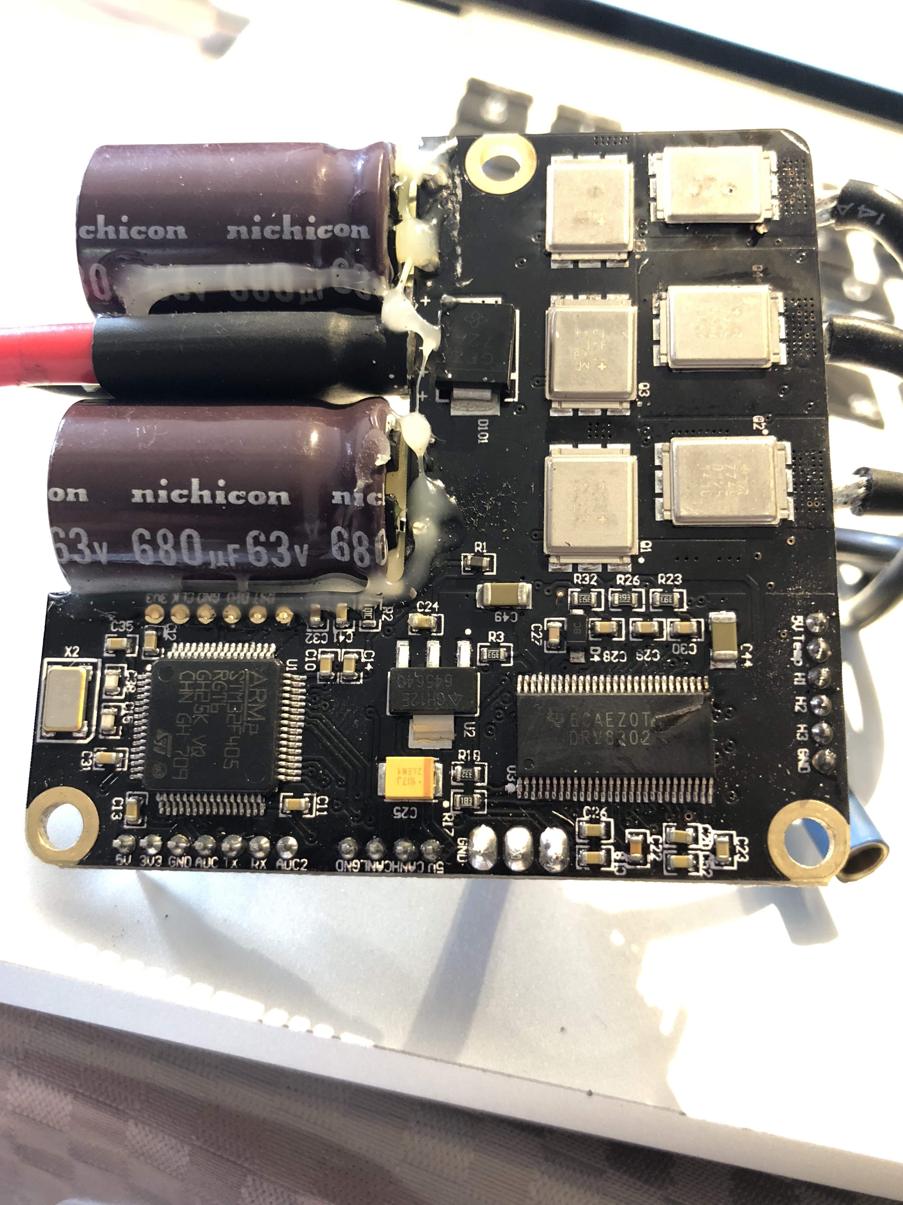

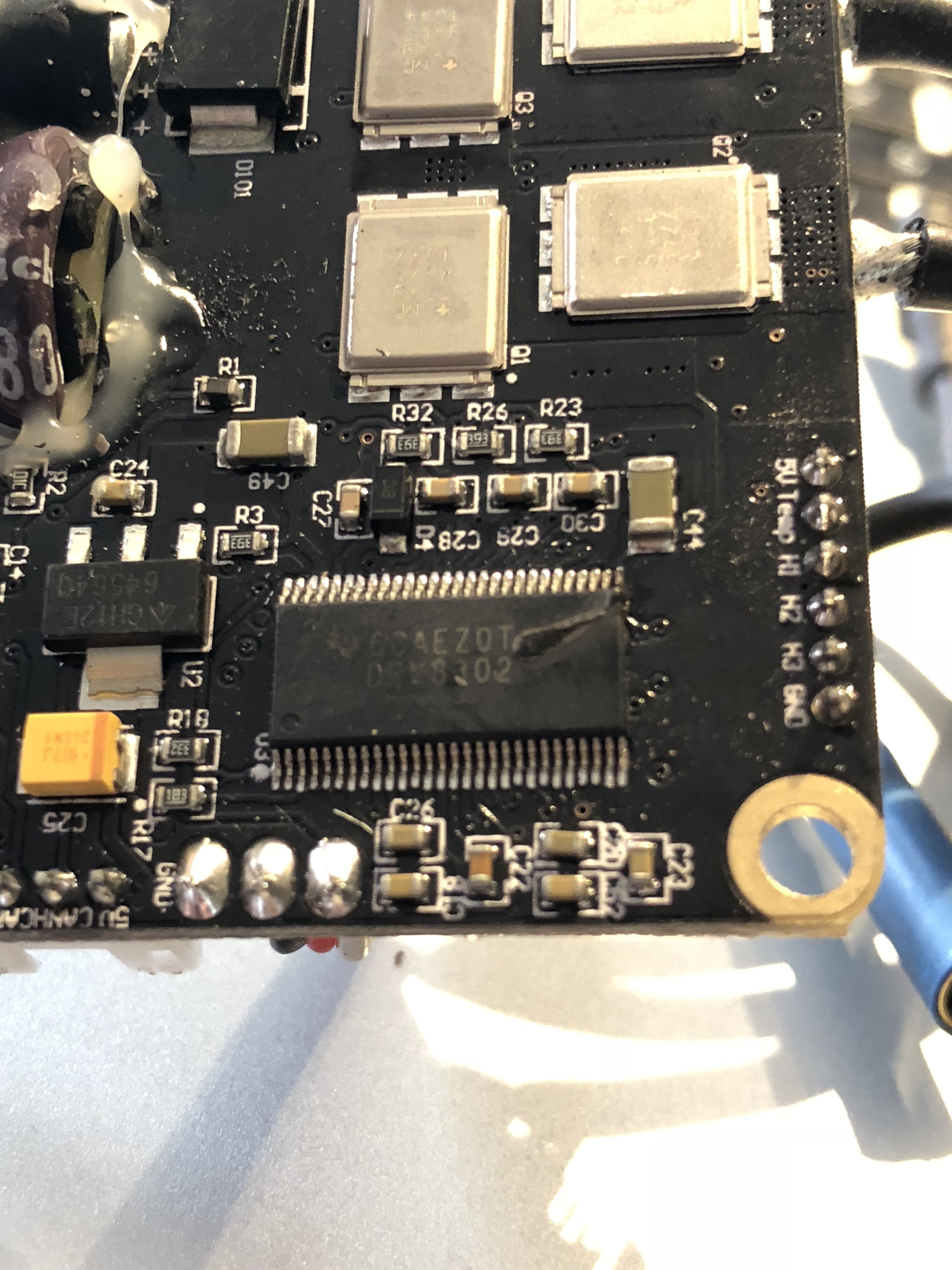

today I was testing my new remote on the bench when my focbox blew up because I was stupid and did some unloaded rev ups. Can I repair it myself? I have some experience with soldering smd and I have a rework station. Does anyone know which parts I need to order. If I can fix it, I will no longer run in FOC mode again… back to BLDC.

Definitely the DVR is blown. Contact @JohnnyMeduse he is the go to repair dude for vesc/focbox
