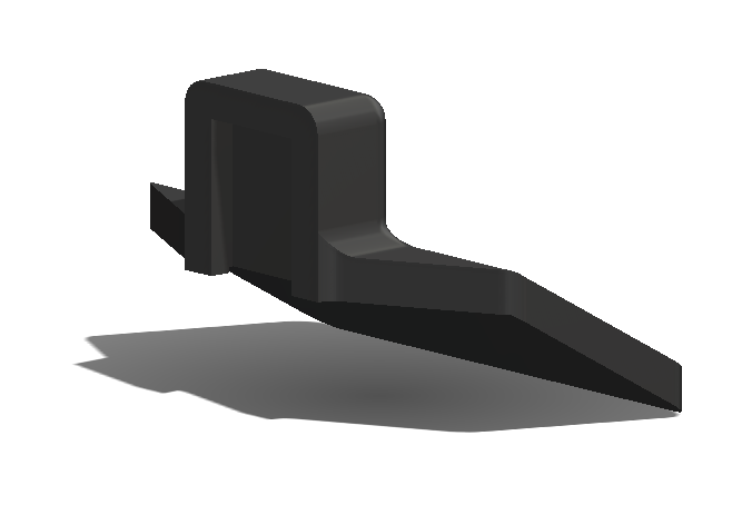

I haven’t done it yet, was covered up at work. Ill do my best to get it done tomorrow. I could design the mount to use a pivot joint, but it wouldn’t be as strong. I would suggest just doing it on a 30deg tilt.
I thought this image was from the .stf file already done! I mean that I am going to use in my regular board, i don’t need this modifications for Trampa’s board.
That one is done.
