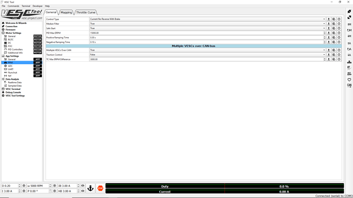

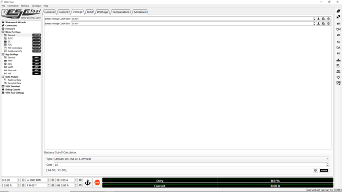

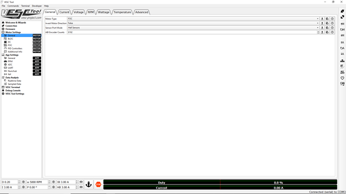

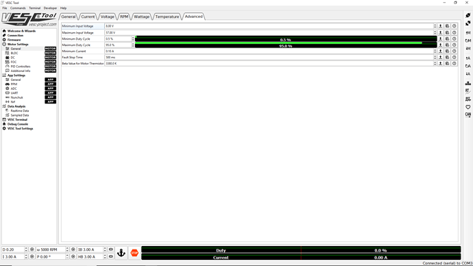

should screen shot your settings and post em, so we can look them over.

please verify the absolute current limit setting is set well above the battery and motor current limit settings.

settings…post…please
