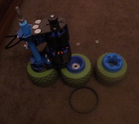

I finished my first DIY-Build, mostly Enertion parts and some custom modifications, thanks to Jason and this community, now I call myself an Esk8-Builder
Speed: ca. 40 km/h (calculated)
Range: ca. 35 km (not tested yet)
Weigth: 9,7 kg
Price: ca. 1500 Eur
Gearing: 13t:40t
Motor Type: Foc (not sure If this is working well)
Waiting for parts: ca. 3 months
Work: 5-7 days
Style: Romulan
In “normal” mode the wings hang down, it was not easy to fit them and not touching the wheels nor the ground.
When I step my backfeet a bit to the front, I stand on the wings and hold them in “attack”-mode, I made this to spike the wheels of stupid segway-drivers
(My first plan was to make the wings aerodynamic so that they go up at a certain speed, but this didn’t work)
I’ve set up a YT-Playlist on my channel for this build, there are no videos of the board yet (just preview and unboxing), but I’ll add some the next days and weeks. I’m going to mess around with the VESC/FOC settings and test how the board performs until the VESCs dies (hopefully not)
