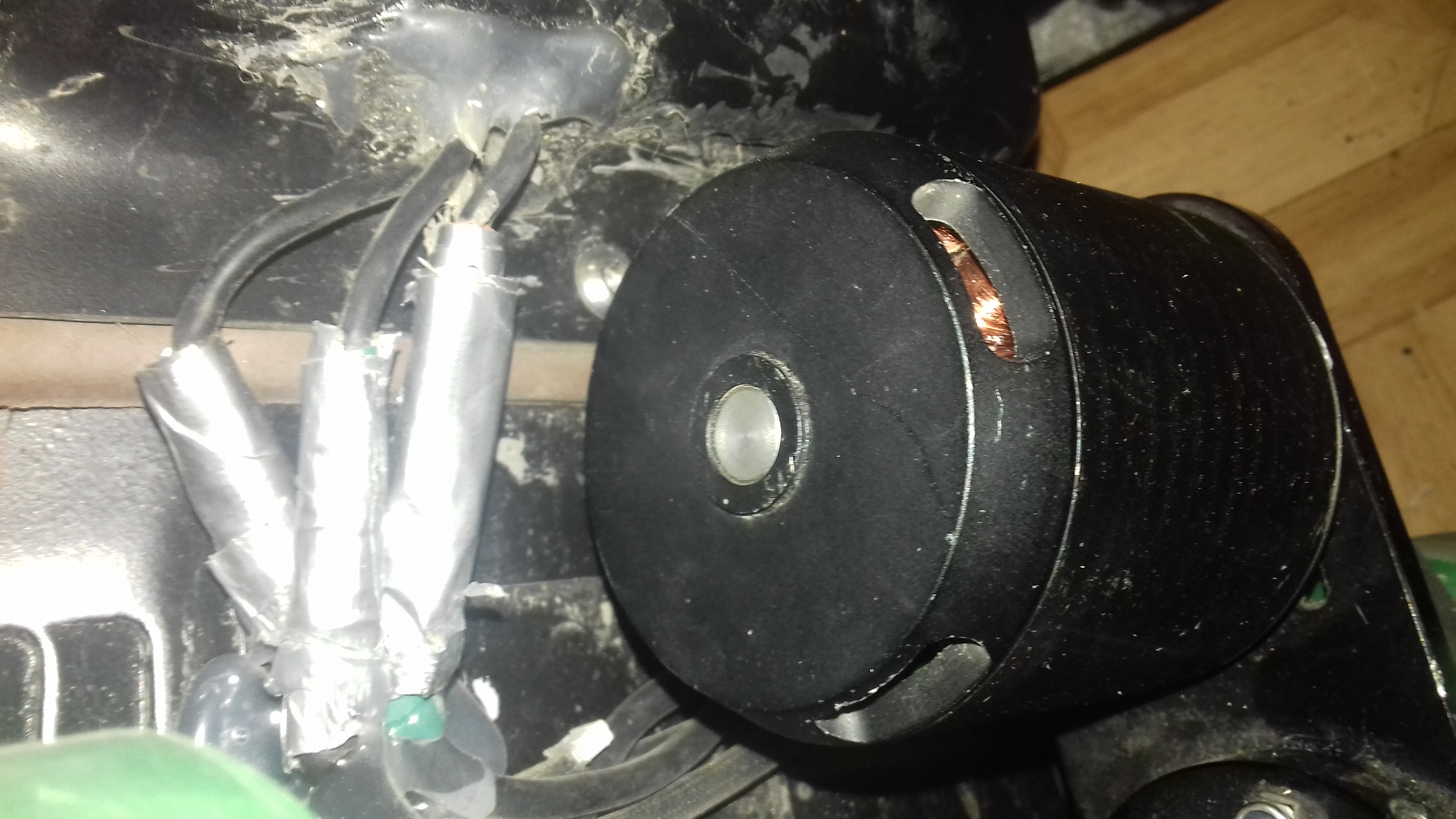

So I broke a belt last week and today after a couple miles my belt literally skinned itself …not sure why think the alignment might be it but not sure … also the motor shaft keeps coming outa flusher withe the can…wtf help please lol these belts are expensive xD
you running dual or single?
give us a pic of skinned belt and motor(s)/mount(s) setup(s)

well iv only 12mm pulleys and 12mm belts are what im using i think but am not sure that its alignment…along with the dodgy motor shaft
can you rotate 2nd pic and put a space in between pics. looks like it is a bit mis aligned
having trouble rotating it lol
your belt is pulling motor towards the wheel pulley.
ya i was having trouble rotating and having pic stay rotated.
take motor mount off and lay it on flat surface
its the alignment ya…i hate alignment lol so hard get right
