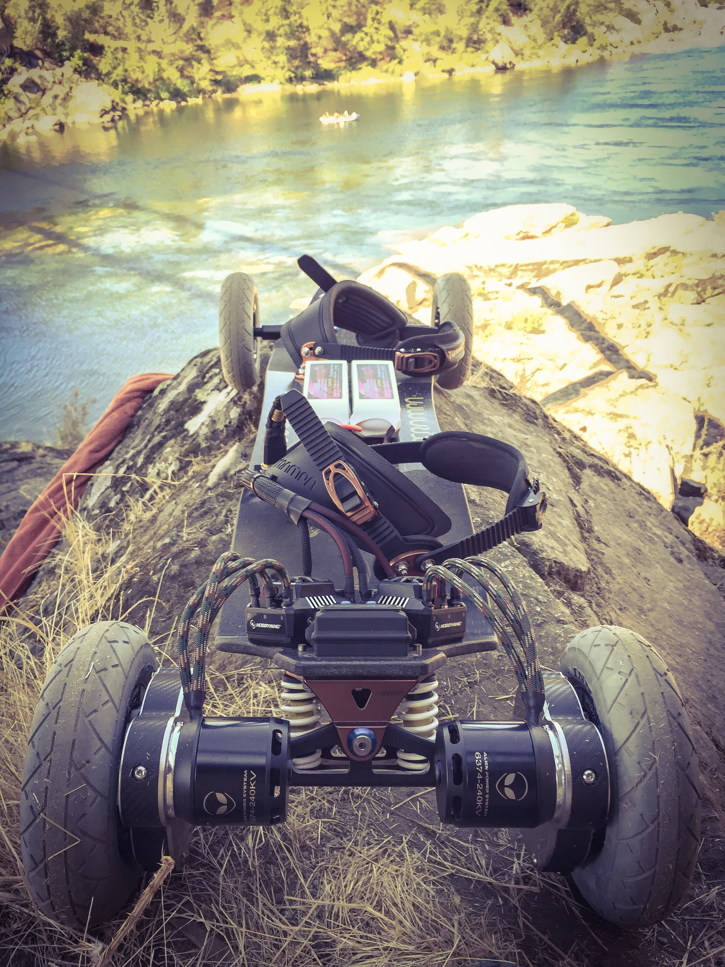

  2. i will check out both those items later today 3.remote was fully charged 4.the antenna is just wrapped up in my reciever box(attached photo) 5.now here is something…lol(attached photo) my reciever is in my reciever box on the back end up the board. BUT i also have a battery capacity meter direcly mounted inside that box, very close to my reciever. the power wires for that meter are only 22 gauge, so there isnt any high amps going through it but its still running out the same chase as the ppm wires. very interesting. and yes the smart thing to do would be to not touch the throttle, i just wasnt sure what was going on. man it hurt too. my body aches because of it haha
You can see here where the battery capacity meter and box is
what motor mounts are those? i like them a lot.
direct drive setup from jenso. @Nowind. best/cleanest mounts you can get, no questions asked. i think it cost me about 530usd shipped from germany
