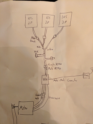

Awesome; just ordered a pack off eBay. Since this will be my first foray into the 18650 world (basic lipos before), can I ask how you’re charging them? Looks like I’ll have to desolder the xt60s and use a standard 42v hoverboard power supply…
I wired them all in parallel keeping the XT60 connections. Then I paralleled a connector from my charger I already have from an electric bike. It’s an XLR connector. Charging at 2Amps takes about 5 hours. No need to charge each independently.
Looks interesting. Maybe he could do some custom builds ?
Would you mind sketching/verbally describing a super basic wiring diagram of how you connected everything together to charge without needing to disconnect the xt60 connectors? This is my first time wiring everything up, and I’m a bit confused as to how to solder in my XLR charging port without connecting to the individual BMS’s. Many thanks if this is possible!
So you can see in this the XLR connector (or any connector really) will charge all the batteries at the same time. I can even remove my loop key to keep everything off as well and still charge.
Edit: I noticed the right most pack looks like it’s connected in series. It’s a mistake, but I know it’s parallel. Most might not assume the mistake so I want to make sure no one catches things on fire.
Awesome- that is so helpful. Many thanks!
