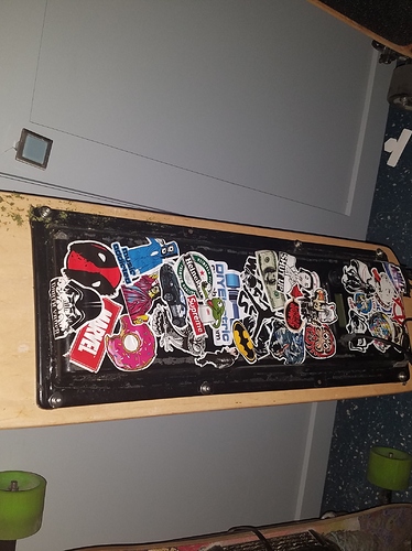

Been working on another belt build but found a guy on Craigslist locally selling a space cell 10s3p, ollin vesc, torque boards single hub motor and nano remote for $320, picked it up quick because the price was so good. Got it all put together today and it rides great. Went to plug in the charger he gave me and it won’t charge. The light just blinks red to green. I tried my charger for my 12s4p torque boards battery and it works but it charges CRAZY slow. Wondering if anyone else has experience with the space cells and can suggest chargers. @onloop do you guys still sell chargers or is there a good local solution for me to look at in the states? Loving this board outside the charging issues!
