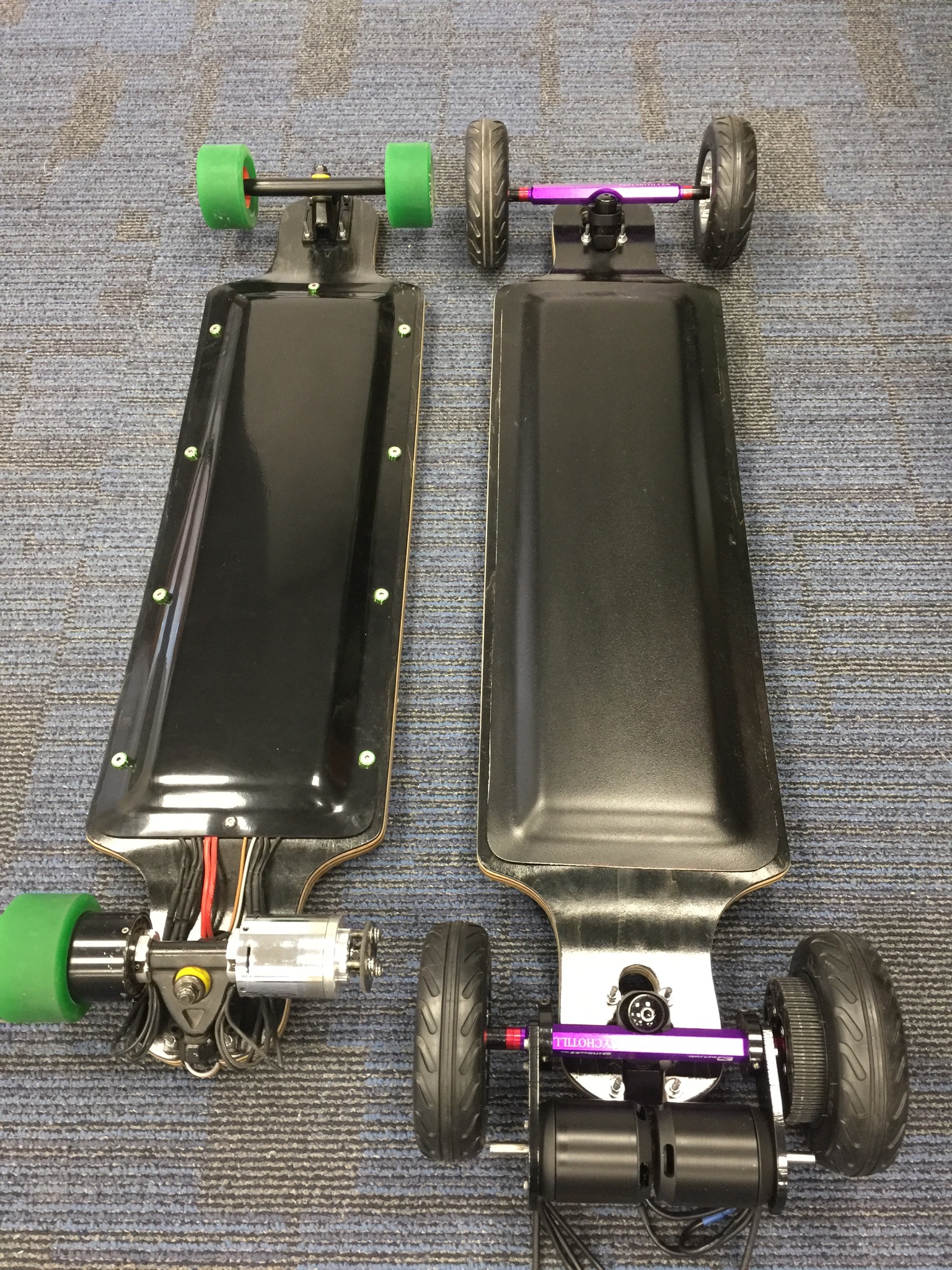

@skunk so that deck looks like it’s got slots for the batteries? That’s pretty cool! Are you able to post pictures of your board so I can see the underside?

Are you able to post pictures of the board with the wires coming out, on/off button, etc etc etc. I also need it to fit my heat sink plate. Will that work?

So I’m looking through these threads and I love the deck but my concern is the enclosures. I love the fact that it’s meant to be super slim and beautiful but I feel that slimness is removing some functionality. For example, I can’t see where people are putting their on/off switch, battery percentage reader and charge ports?
I’d like those things to be on the enclosure aswell. And again, I’ve not seen anyone using a heat sink plate with the enclosure?
Maybe this isn’t the right deck for me. I won’t be sold unless I can have all the above.

I’ve been using push to start and app for voltage display so done away with 2 of the need for holes. I stuck a hole in the side for charge port.
There is another version of the enclosure that covers the wires.
The heat sink plate should be able to be cut through the fibreglass enclosure and bonded to it.
Some switches and meters are integrated into a cover for the dropthrough holes.
@amazingdave is doing something like that here.

My thinking is having the switch, screen and charge port on the bottom of the deck facing the ground? Similar to the Enertion boards.

Here’s an example of tillers enclosure that someone put a heatsink on.
Although I’m sure you could do the same thing with Big Bender enclosure. Both look great
