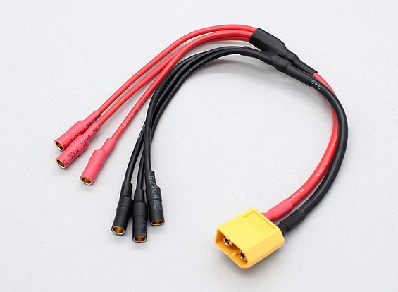

Like this?
and this?

The XT60 connector is wrong but the balance adapter is correct.
The batteries have female connectors, you need a lead with male connectors… Plus, that’s a parallel connector not series.
90% is a little optimistic, but it’s more dependent on the roads in my experience. Your series cable is wrong (you have a parallel cable); assuming you don’t want to solder:
Your battery has 4mm bullets, not 3.5. Depending on your ESC you might need an adapter for that as well. Don’t forget an anti-spark switch / power button!
