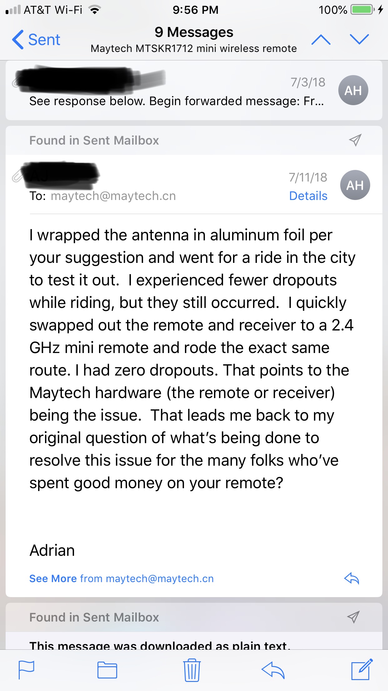

Reviving this thread. I decided to write Maytech to let them know about all the dropouts everyone was experiencing with their remotes when riding in RF noisy areas. I have two of their remotes and wasn’t too happy about having spent decent money on them only to find they’re unrideable in the city. Below is the email conversation I had with them. Looks like they’ll be churning out a new version of their remote to correct the RF interference issue.
