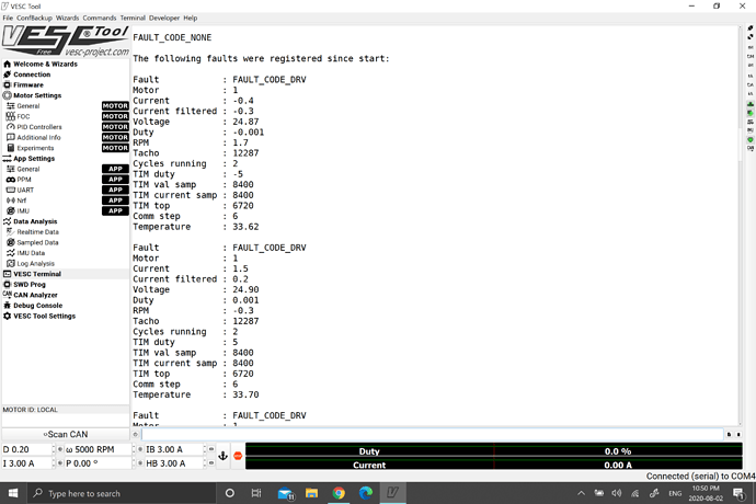

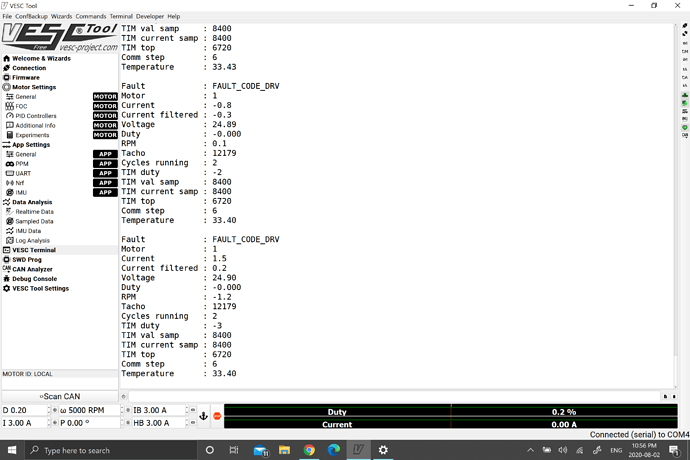

Just re-flashed the firmware, got the motor detection to spin the motors albeit taking its sweet time to register anything before doing so, went through the control setup and tried using the keyboard keys…no response in either I took a screenshot of a few of the errors that popped up on the command line if they help?

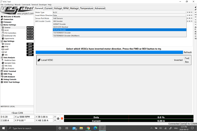

Did you check the setup motors FOC ? Do you have sensors on your motor?(a 4th cable with 5-6 smaller cables ?) if not you should change the sensor port mode on the VESC tool (at 1:01 on your video)

Hey Josh, so do go through your points in order, if i am not mistaken FOC and BLDC differ in the motor you use and i figured mine might be BLDC and therefore i didn’t setup on FOC, the motor didn’t come with the Hall sensors (only 3 cables out of it), but the sensor port mode doesnt have a “None option”, so i left the default there…

So you could try to put it back to FOC in the General motor setting then go in the FOC (under the General button) to change the sensor mode to sensorless
