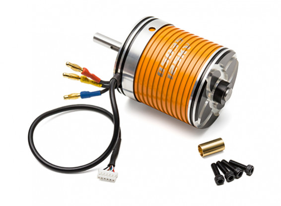

Starting this build as i need to start all over again, Just sold my Trampa Kaly built by the man him self(get well soon). I have had 3 self builds,Metroboard,Kaly Trampa,Raptor 2.1 on the way. Not in that order but you get it. I have been out of the game for over a year i had extra bits in my heart they had to cut out now i’m heartless and feeling better its about time at 45. This will never do any real off roading . This is the list some parts i have that i never used, Vesc-Dual FSESC6.6 on order… Motors-Turnigy D5035-125KV Sensored Brushless Motor x2 have one one on order… Battery-12s5p Eskating Samsung 30Q I have… Bms-BESTECH BMS 80A… Deck-MBS Pro 97 – Dylan Warren II Deck stiff … Truck Type – Metal Matrix II… Hubs-Rockstar Pro T1 Tyre… Motor mount -Overion … Gears- Overion chain spocket kit 10/42… Abs Enclosure c/w Waterproof gasket…

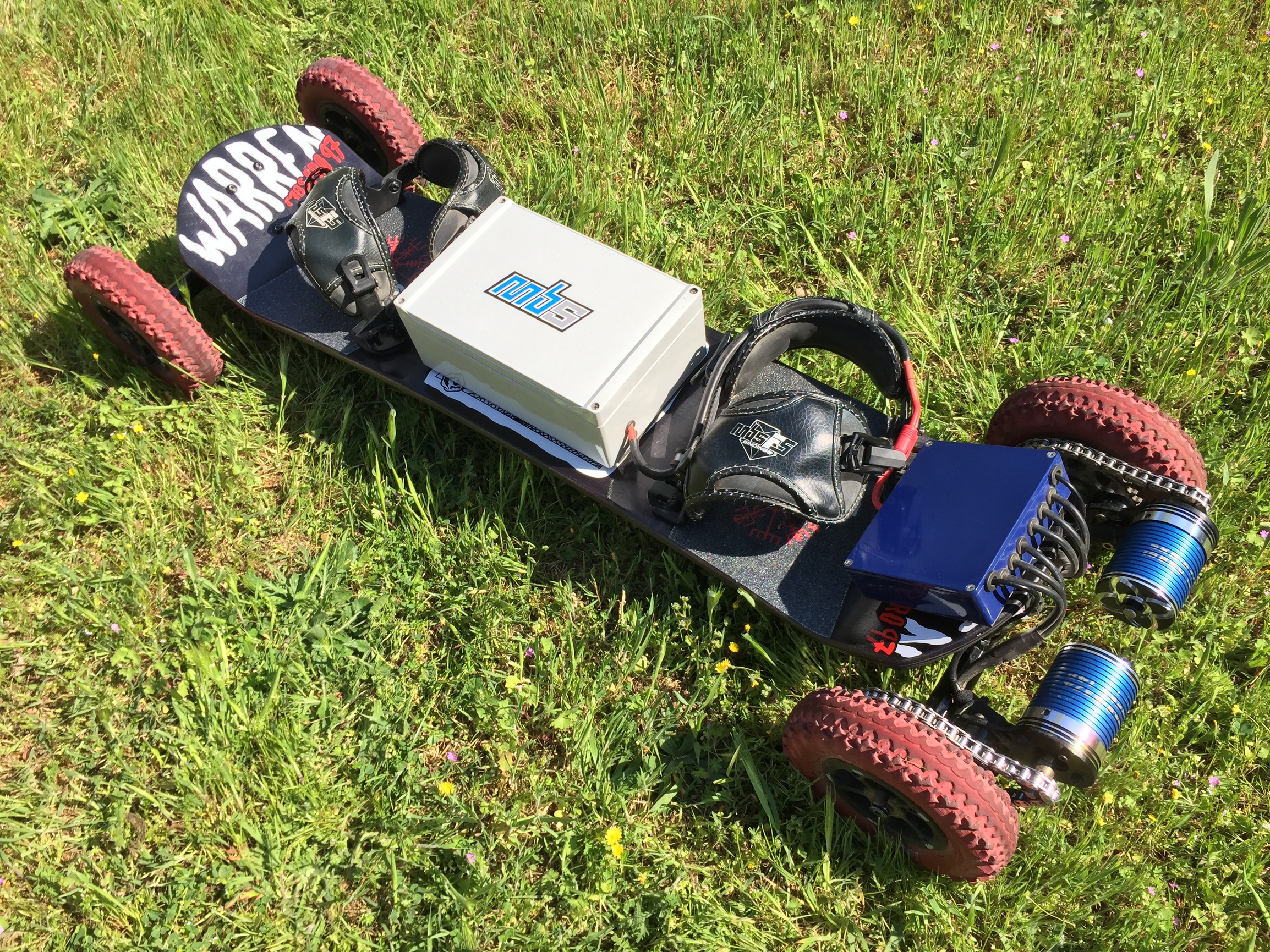

Good choix! I did the same except the motor (SK8 6374 192KV).
I use this box for the esc : HAMMOND 1590XXCB.
What size gears did you use
OVERION Mount but E-TOXX 8T and 40T motor and wheel sprockets.
Your motors’ KV is lower and I would choose 10/35 OVERION sprockets.
The 42T sprocket will be heavy IMO. No big deal you’ll be able to change it easily.
Overion mounts are great! I use 10/42 and love them. With 10mm shaft and 6374 130kv , the feeling was superb! about 40 km/h top speed, now I am using 154 kv 8mm shaft Trampa, they are really fast 50km/h easy…But I prefer the 130kv motor and bigger shaft, I am trying to fix one broken motor to go back to that set up… Also, Yann from Overion is a very nice person!

These turnigy SK8 take 67A.
