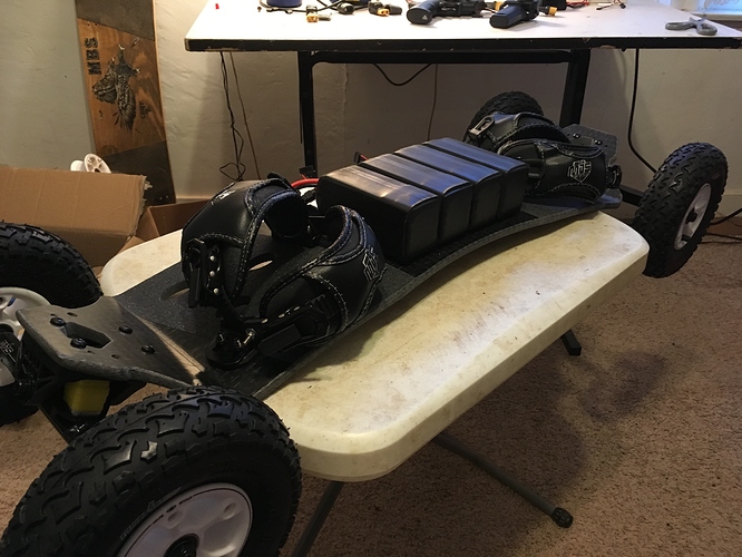

Gearing up for my next build here guys. Waiting on a couple more items. Gonna be sick!
Still waiting on some parts, figured I’d put together what I can.
Some fancy lookin’ batteries here. Almost didn’t wanna cover 'em with shrink wrap. Was gonna go with Zippies, but they’re a little longer than the Graphines, and I was concerned about having enough space for all the wiring. Don’t want any wire protruding from the edge of the deck if at all possible. Nice they come with XT90s. Little less soldering to do.

Very nice super clean
I like the 9inch wheels
That is a monster
Love the look of it
