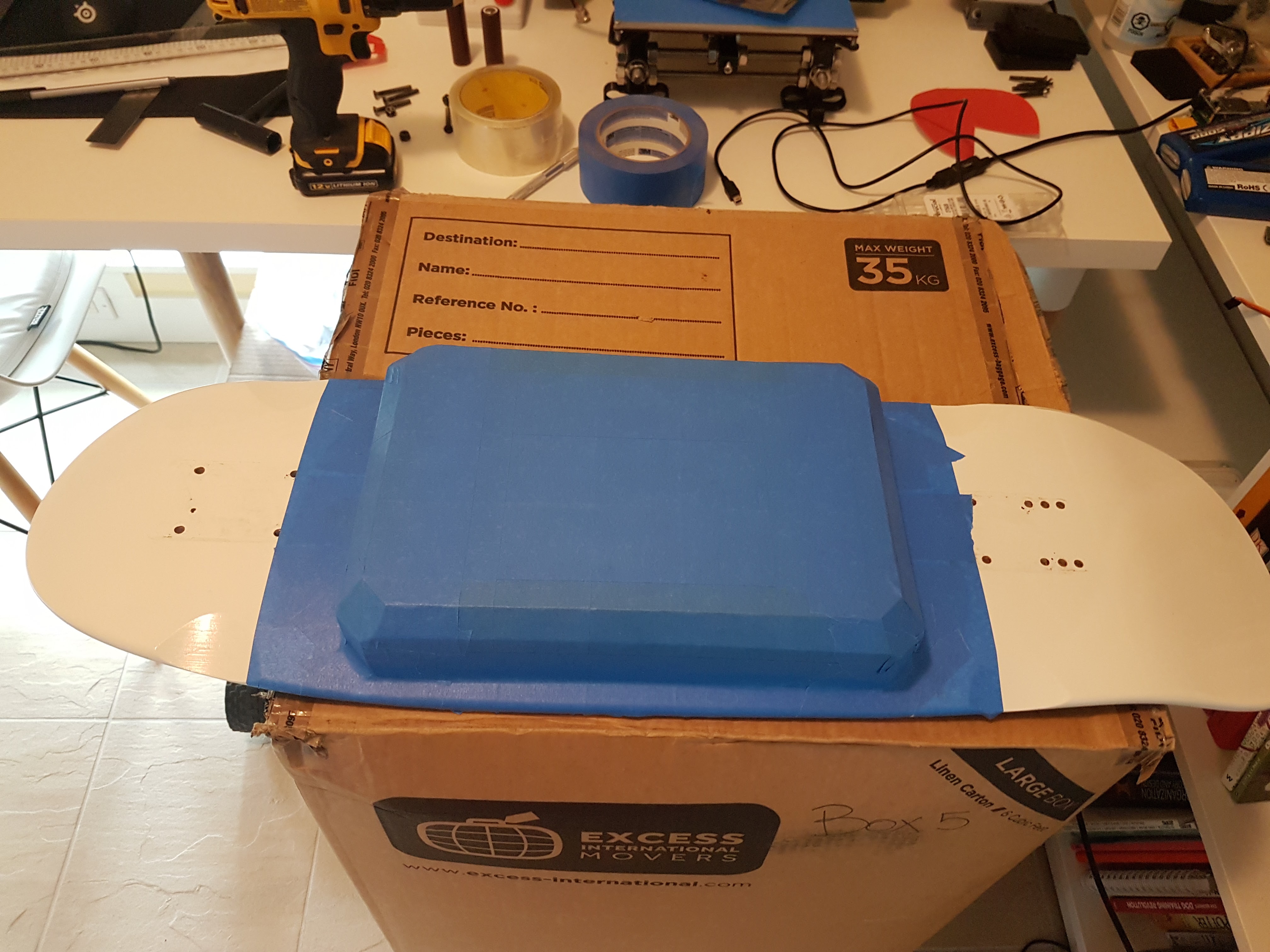

Problem is, you need to have some sidewall angle to get a vacuum formed shape to release. If you want a 2" tall enclosure it’ll have to be too narrow at the top of the mold to be wide enough for components, Or the alternative, too wide at the flange or base of the enclosure to fit on any deck. 8" wide x 2" tall are really goofy dimensions.
Check the pictures i uploaded, that’s the mold ill try to use.
