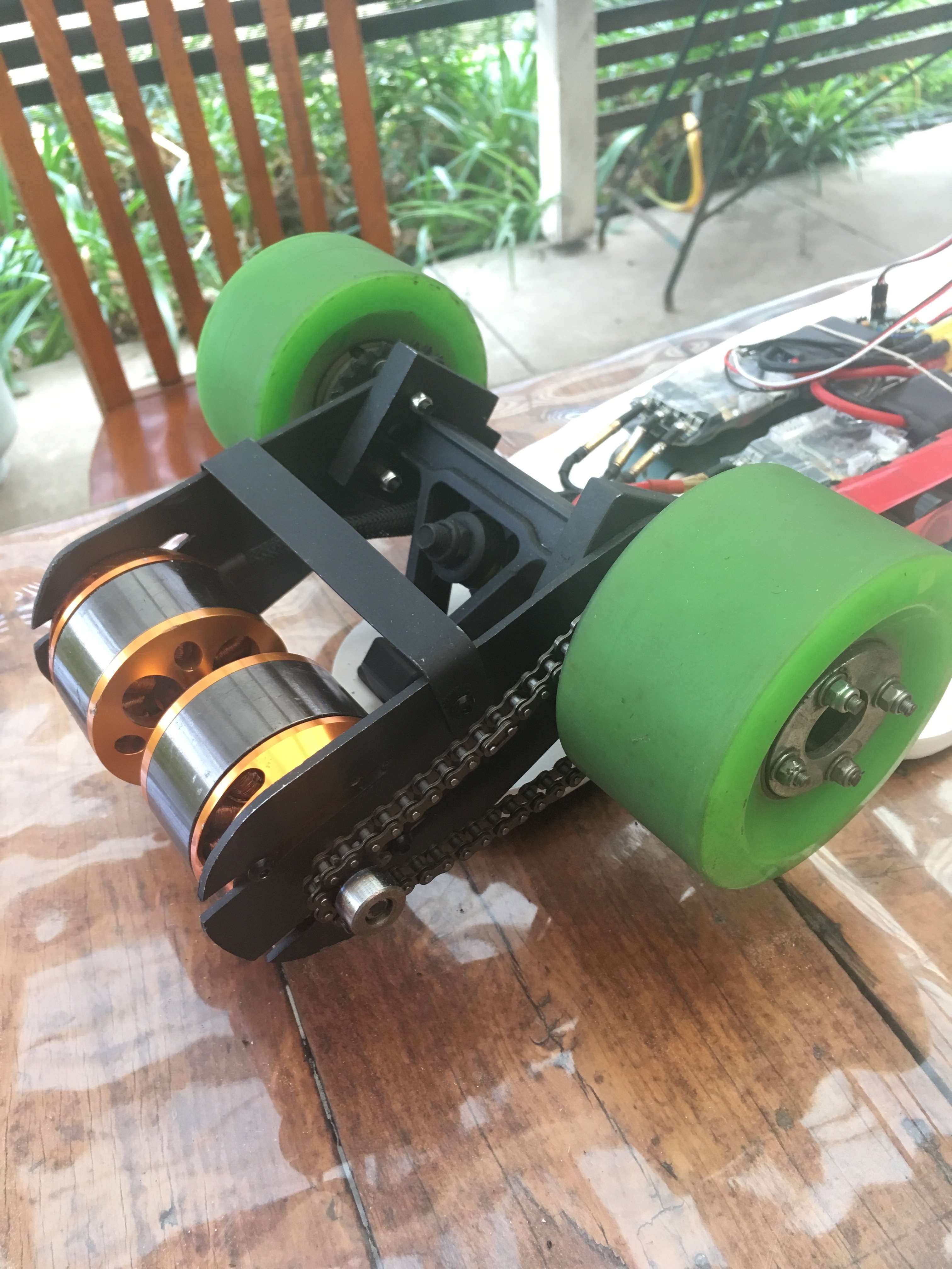

You are probs better off buying some scrap metal and cutting/ filing that until it fits your needs. Here’s my attempt, I needed reverse mounts for hobbyking trucks, turned out pretty well for a hacksaw, grinder and file job
Oh yeah and these cost me $4 for the aluminium clamp, the steel plate was some scrap square tubing, and the paint I already had. Total price - $4
But not so sexy. Sex sells
You forgot to leave out the mad McGuiver skills needed. Hah. Well done.
