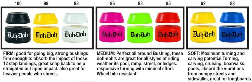

Fancy brand names on left (doh dohs) vs cheap chinese.( on old carbon )
Both these have done 100+km
the chinese bushings have been on for ages they dont degrade, just slightly squash.
Brand names are recked.!

Just not Doh Dohs, as they are in my pic above. Hard but shortlived!
