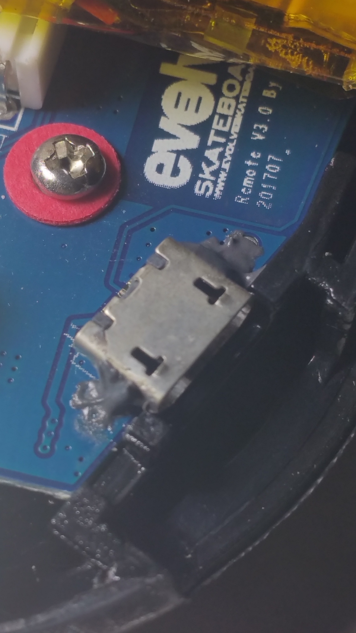

The issue, the brake spring on my kids r2 fell off inside the remote under normal conditions.
The result, the spring dislodged the sms switch for the brake located on the motherboard.
I spotted the issue under a microscope.
I then re-soldered it and reassembled the remote thus putting a dab of jb weld on the plastic pin that holds the spring.
This should never happen on such a critical part.
Just letting you guys know.
Do yourself a favour, when you get your new r2 remote carefully split the case and put a small dab of jb weld on the brake spring as well as the usb connector.
It will save you a lot of grief down the road.
PS use a toothpick
