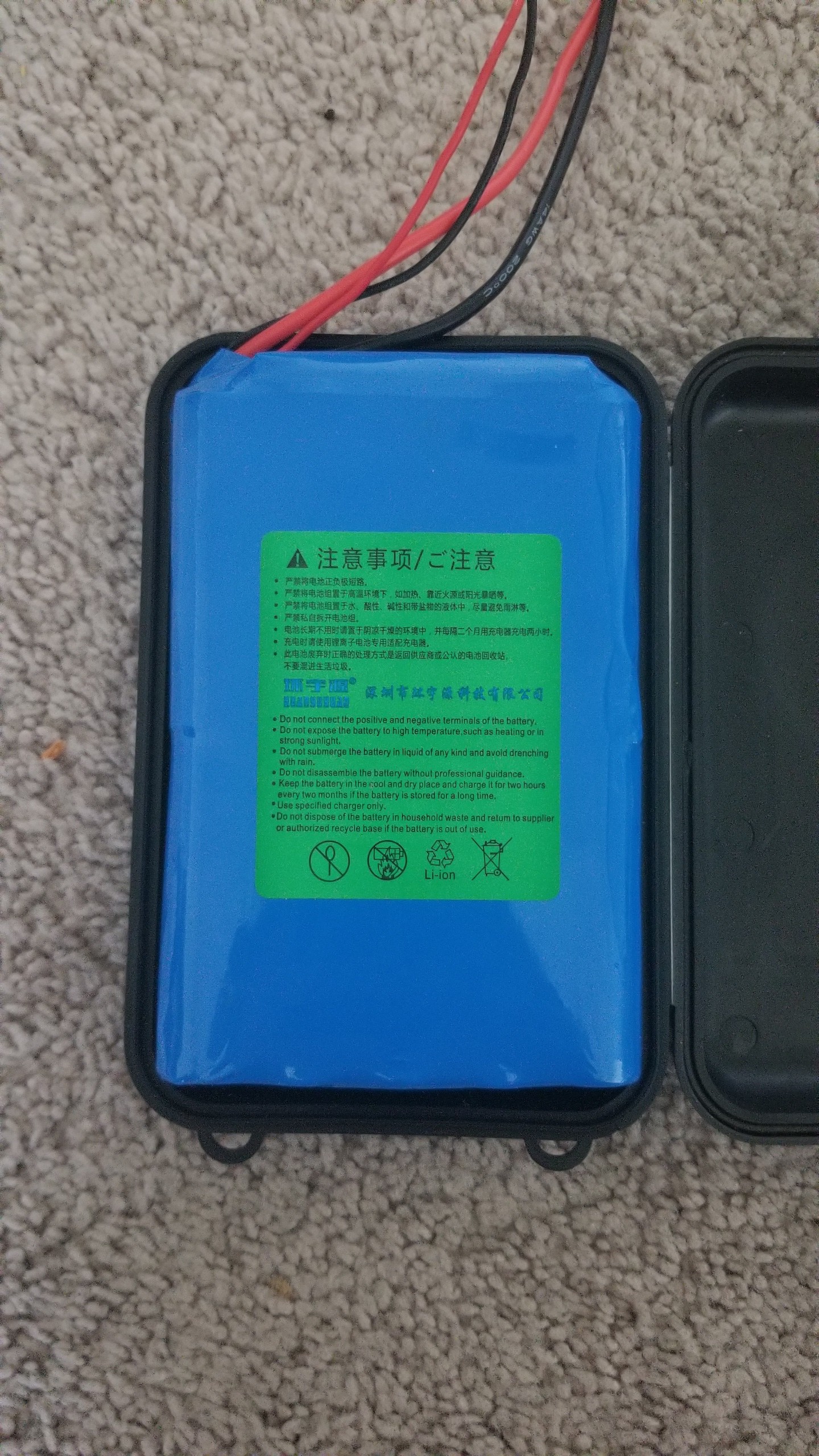

So I got a kit from diyeboards and started experimenting. I ordered a random box that looked about right to me off ebay and lucky me look how well the 10s2p pack from the kit fits into it:
20181005_160638
