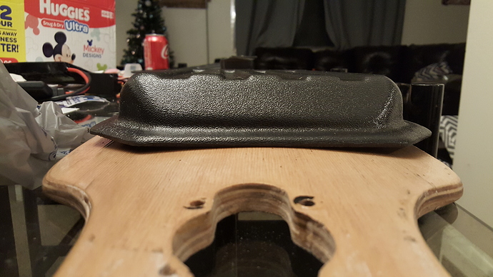

First build! Diy 6s4p pack/ diy 6s esc/ ebay deck/ 83mm wheels/ winning remote/ single drive 230kv/psychotiller 405 enclosure
I finally built my first board! Man is it fasthat and extremely fun. Max speed of 21mph which is way more then I need or want to go. I climbed a 20% grade hill with no effort on the boards side. I already want to jump to 97mm wheels for more ride quality. Do I need a 40t wheel pulley for that size wheel? Also when I charge the board it kicks on the esc even with the switch off. Is that normal @torqueboards do I need to install a loop key?
Uploading…
Yeah, correct it will turn on when charging. It’s normal.
Ok as long as I don’t burn anything up I’m good!
How much do you weigh? A single 6355 doesnt have the most power I would think.
150lbs. I think some people are just over engineering there stuff on here. Everyone to me to get a 10s pack but a 6s is plenty for me
