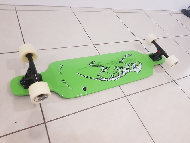

So basically I’m looking for a reasonable set up probably rated to 12s ? I want to future proof my self and figure i can alway just run a smaller battery if its to at first. Any suggestions on kits mounts ect ?

Looks like you have Paris trucks, its a little difficult to find motor mounts for them. Look the RIPBA motor mounts from @psychotiller, they are great with a little work.
https://psychotiller.com/product/ripba-mount
I would suggest 10s instead of 12s, its safer (regarding the ERPM limit on VESC’s) and cheaper. You could go with series connected 5s (x2) or 2s (x5) lipos for a cheap but well performing battery pack.
