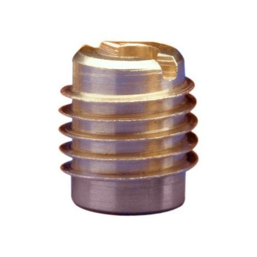

Thought I would give back a to the community a little. The other day I cracked my Carbon Gen 2 deck, so I built a frame, riveted the battery pack to it and then used E-Z Lok Threaded Inserts to screw it to the board. Pictures below with items used and prices, hopefully this will help someone at some point in time, because buying a new carbon deck for ($500.00) is kinda crazy.
Frame Dimensions:
- 3/8 Thick
- 6.75" Wide
- 30.25 Long
- Eversesh Longboard Deck ($76.95)
- E-Z LOK Drive Tool ($14.00) https://www.amazon.com/gp/product/B0025QCIG6/ref=oh_aui_detailpage_o00_s00?ie=UTF8&psc=1 - E-Z Lok Threaded Insert ($9.75) https://www.amazon.com/gp/product/B002WC8TPW/ref=oh_aui_detailpage_o00_s01?ie=UTF8&psc=1 - Stanley TRE550Z Electric Staple/Brad Nail Gun ($29.99) https://www.amazon.com/Stanley-TRE550Z-Electric-Staple-Brad/dp/B000BPSUTM/ref=sr_1_3?s=industrial&ie=UTF8&qid=1506126594&sr=1-3&keywords=stanley+staple+gun - Stanley Heavy-Duty Staples ($5.82) https://www.amazon.com/Stanley-TRA700BN-Heavy-Duty-Assortment-2500-Pack/dp/B0051QUOO0/ref=pd_bxgy_469_img_2?_encoding=UTF8&pd_rd_i=B0051QUOO0&pd_rd_r=0ZH7QVKY505XHVYC5567&pd_rd_w=Bn3yv&pd_rd_wg=lsk1C&psc=1&refRID=0ZH7QVKY505XHVYC5567&dpID=51BT6dFBGzL&preST=_SY300_QL70_&dpSrc=detail - Rivet Gun ($12.61) https://www.amazon.com/TEKTON-6555-Rivet-40-Piece-Rivets/dp/B000NPT74C/ref=sr_1_4?s=hi&ie=UTF8&qid=1506126712&sr=1-4&keywords=rivet+gun -Small Piece of Oak Wood from local Hardware store ($10.00)
