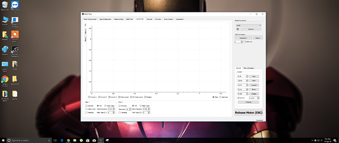

I took a took a new focbox from enertionboards.com from the i got it im face problem, my motor is not moving at all i searched every were on YouTube and did all as per video said to do yet facing problem,
after some days i brought a new ESC from amazon n wen i started the ESC it worked flawless
for battery im using benchtype power supply at 42v and it has a amp lemet of 10Ah
plz help need to get my project done

Lots of things wrong here.
Motor detection failed. You didn’t do a motor detection.
No app setup. You didn’t setup the receiver
Max current ramp step doesn’t show. CLICK READ SETTINGS FIRST, then screenshot it.
You’ve got a overcurrent error. Are you using battery or a power supply?
You didn’t even setup the focbox. Follow the guide and report back if you have a problem.
