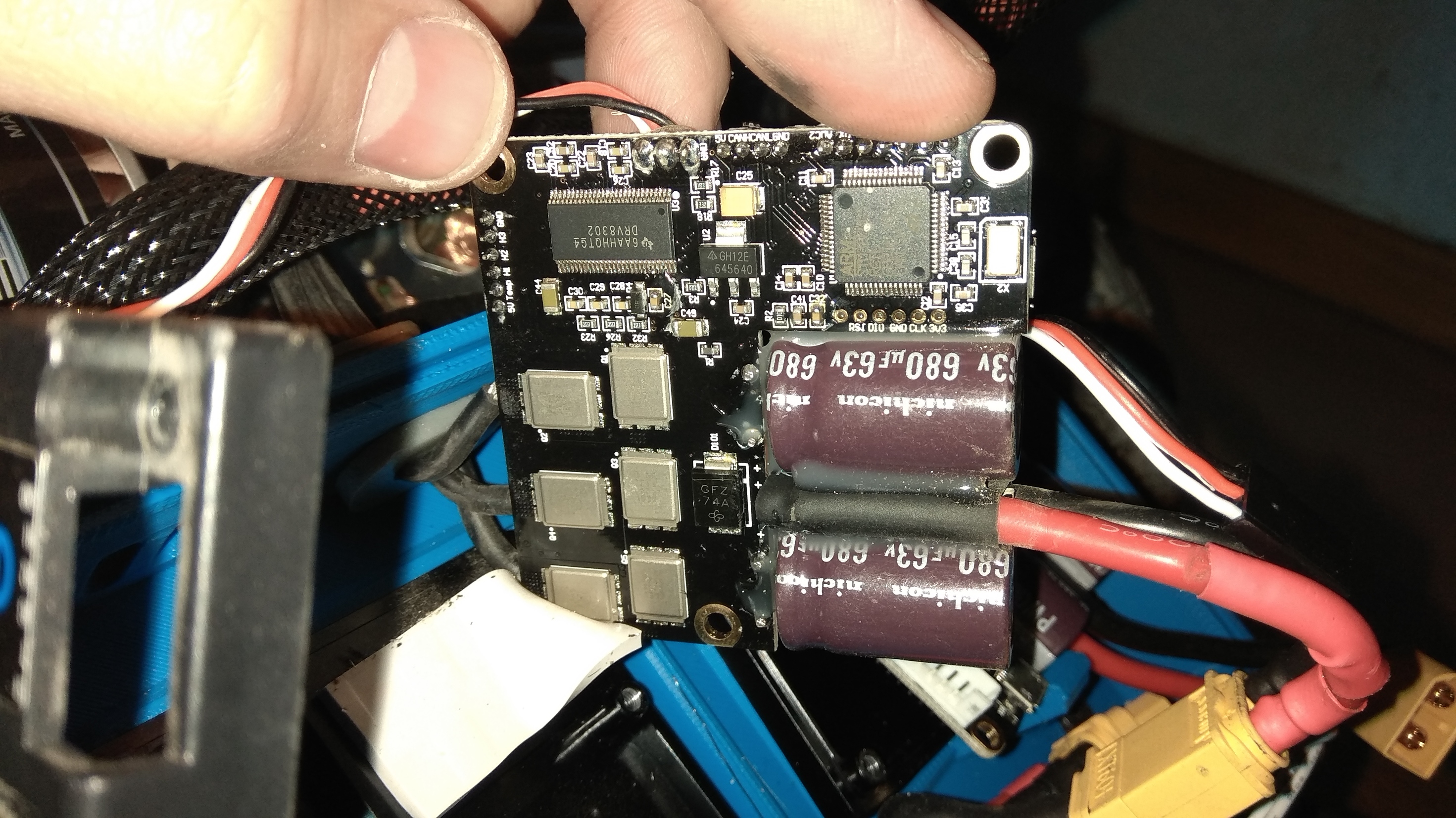

I had the same problem. No fault. Visual inspection turned up a bubble on Vesc. Sent it into DRVWizard who confirmed it was DRV failure and did chip replacement. Bought it back flashed it with Ackmanic’s fw and been happy ever since.
As you can see from the picture above R46 is suppose to be 39Kohms, so the low impedance could be cause by the mosfet, the DRV or the resistor. But I can tell from experience, It is alway the DRV.
