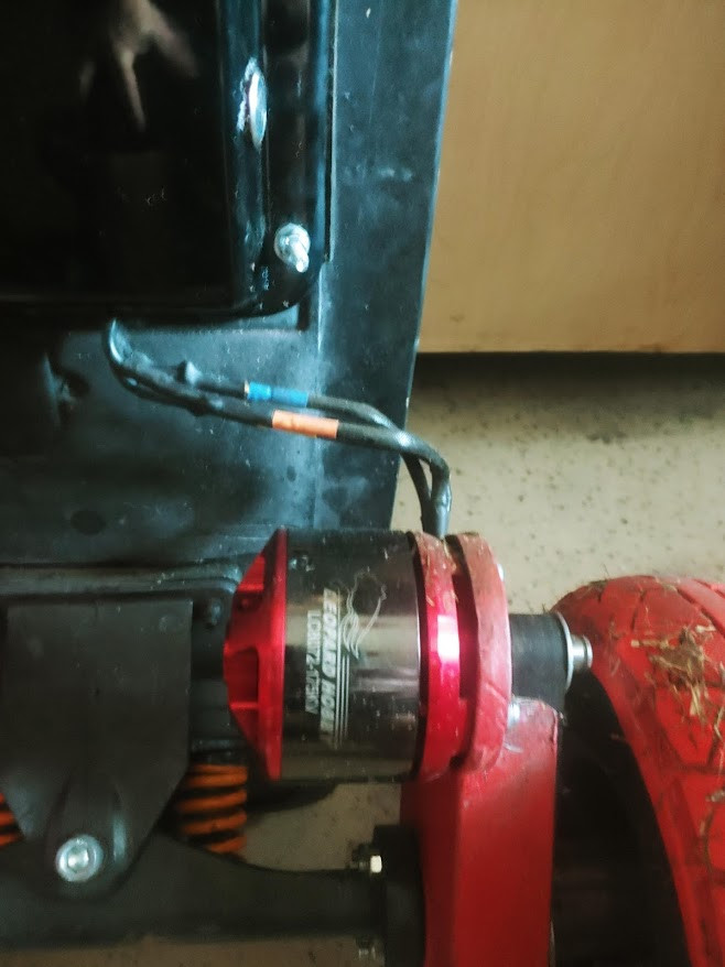

@Andy87 THANK YOU! The motors don’t have sensors. I’ve attached 3 pix and a video. This is my first build with the Leopart 8072, 175KV motors. They are sensorless. The battery (Samsung 18650) and ESC, I’ve used before, in fact the build right next to it has the same 12s4p 18650 samsung batter. Here is the LINK to the Leopard Motor Description. LEOPARD MOTOR LINK
In a post below the 3 pictures, I’ve also posted a video of the motors spinning unwrighted. With no weight on it, the wheels spin extremely fast and demonstrate the acceleration I would expect. I’ve analyzed the motors, pulleys and the wheels mechanically to ensure their is no rubbing or friction, All seem to spin freely… They each are drawing ~80 amps (160a total) VESC is rated for 200a. What do you thnk? THANK YOU!!
LINK TO PHOTOS
Please find the attached video for your consideration. As you can see, the unweighted motors generate a lot of speed. When I formatted the VESC, both motors were each showing 80 - 81 amp draws from the battery (160a total) The VESC has a 200a continuous rating

is the cable routing no issue? I feel like they could be routed for less stress.

Also, how could I change the cable routing to get more power?

I changed it to be about the motor wires looking like they did a lot of flexing which can make the motor wires get cut by shaft bits around the cable exit on the motor stator. You can put some glue there to reinforce if you want.
Battery Hookup’s prices look really good. I’m gonna ask a couple really dumb questions, but - is it as simple as just getting their product and shrinkwrapping it? Also, the shape will be a little differentt because I want to do a “single row” to keep the clearance high/. Do you print your enclosures? If you do, do you have any advice for doing that (in the past, I’ve always been able to find a design on Thingverse and sent it to the printer. But, I’m gonna be off-script here. Any thoughts on how to build the file for the printer? THANKS!
That’s a good thought on the wires. Frankly, the last problem I had with the board (before this problem) was that one of the motors kept changing direction. Turns out one of the phase wire connections was moving around. I was gonna just pull some length out of the wire… but, then I rode it and realized it didn’t have enough torque. So, I’ve had to refocus… Like I said, it’s been a year on this thing
