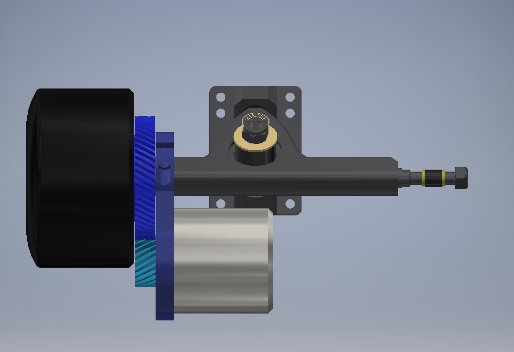

Got bored made a Gear drive
I’ve read about Belts being at their Limit so why not gear drive? Saw the Jed board about half an hour ago and decided… I can do that! Pulleys Anyone have any experience with this?

How are you going to make these? No printing please, except SLM:p
I could very well take advantage of an SLM 280 printer at work… well maybe.
How is the surface finish of SLM parts? Never had one in hands:/ Otherwise brass would be nice i think.

Whelp this is the result. Printing it right now. Gonna print abs to see the fit and if that works annealed NylonX.
How are you going to deal with friction and heat? I guess you will need to enclose it, and put some lube inside.
Didn’t @GrecoMan build something similar? He might be able to give you a couple tips and if it will work well
An advantage belt has is the ability to eat a small stone and flex off the damage, this setup strips gears or fails entirely, or if really strong emergency stops the esk. Needs a cover like any other D/D system for sanity’s sake
Take a look at @Nowind direct Drive. Steel motor pulley and POM drivewheel. Tested hard on mountainboards without wear
I’m using a Alloy 910 printed gear for the wheel on my mountainboard and a steel gear on the motor, so far no problem or visible wear. Would strongly recommend something nylon based.
