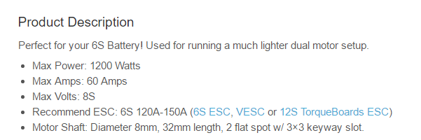

I was checking the TorqueBoards website, and it says max amps is 60 amps. does that mean the highest I can set the motor max to is 60a? or is that for something else?
Well, maybe 65, but you will not need that, especially not with a dual setup.
