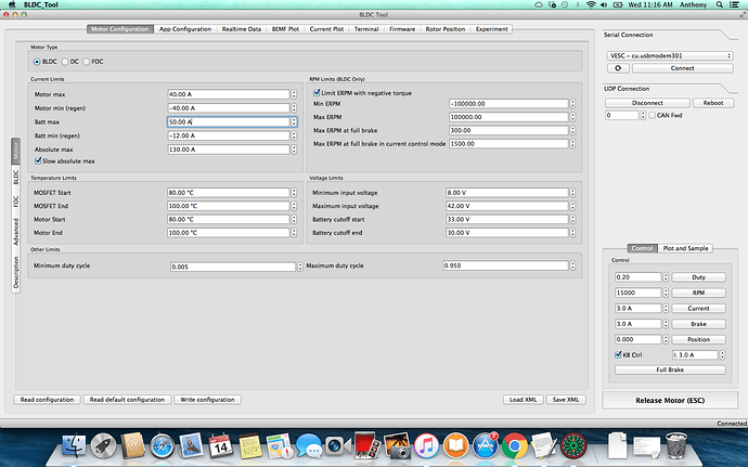

It could be over voltage you can set your max voltage to 57v. It doesn’t sound like a remote issue but vesc issue
Yeah sounds exactly like my issue. Adjusted both my ABS and voltage settings and fixed. You’ll probably see ABS overvoltage error when braking and another over voltage error accelerating.

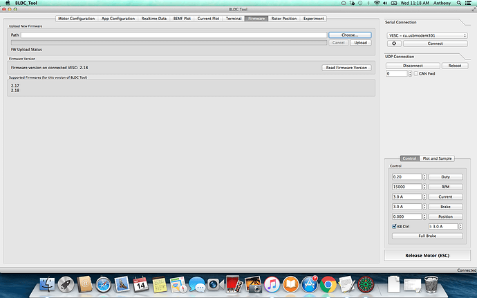

You are having the max current ramp step error, described here: http://www.electric-skateboard.builders/t/psa-remember-to-reset-your-max-current-ramp-step-when-programming-your-vesc/6262
Enertion seems to have sent out a ton of VESC with that error.
Also, better set the value of the “max input voltage” in the motor tab back to the default value of 57V (it’s 42V currently, which might kick in if you are having voltage spikes).
hmm ill be sure to update my vesc then any other tips???
