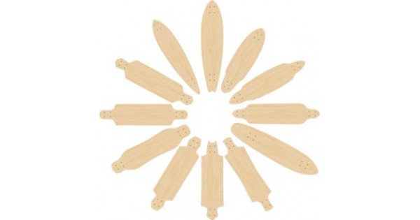

I meant as in, where did you order it from? Or did you make the deck yourself?
