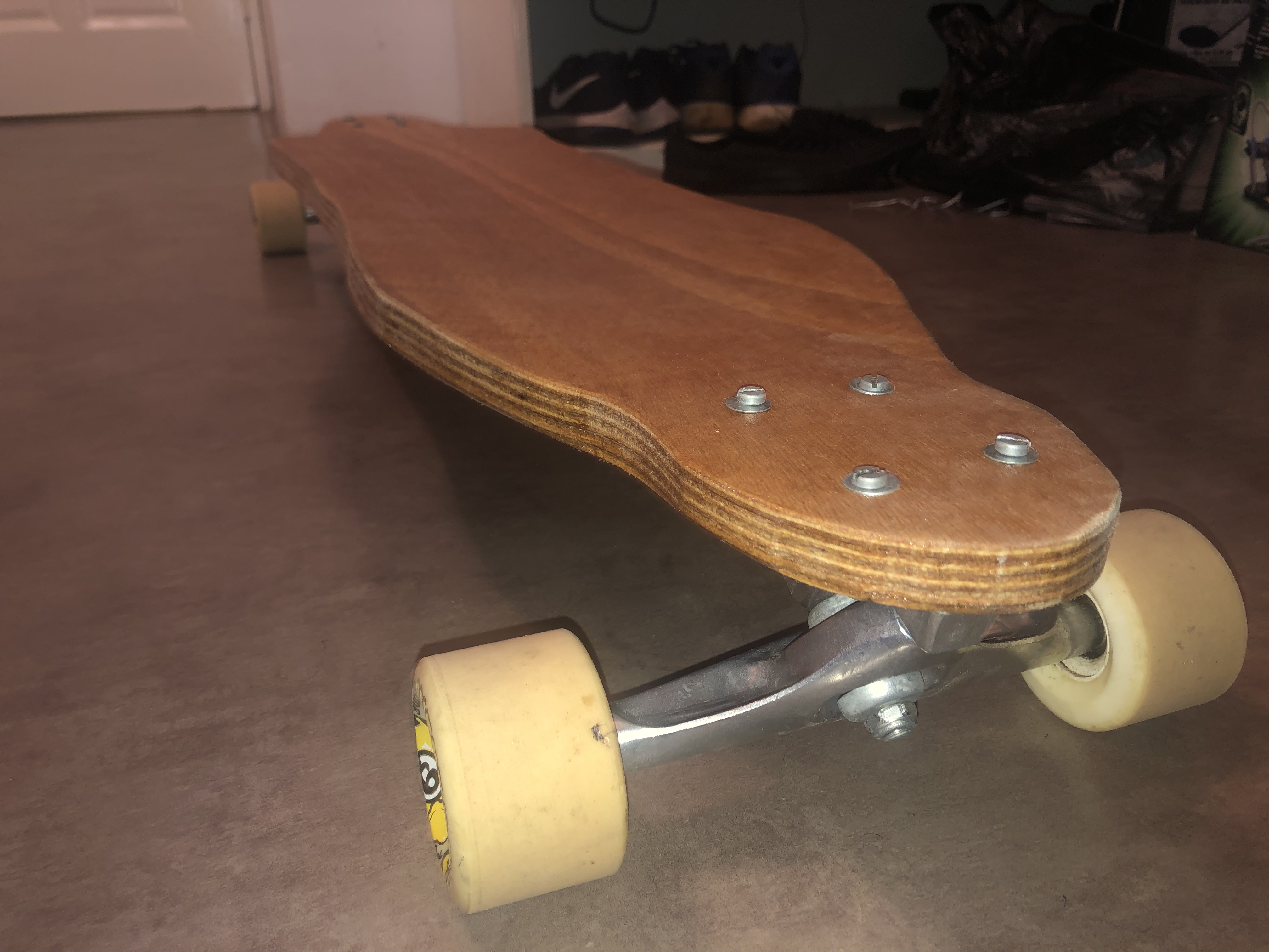

However i’ll strongly recommend to add one or more fiberglass layer between two sheets of maple, it’s a strong wood but for your part that is just over and under the components it may be better to make it harder, more solid you know.
Looking like this with 4 layers (That’s a lot actually, you wouldn’t need this much) in sandwich with epoxy on a non-integrated deck, it is absolutely impossible to flex this one.
After that there is lots of « tricks » to make your deck look less thick, like sanding the borders to have a sort of inverted concave at the bottom, like Haya deck does it actually.
