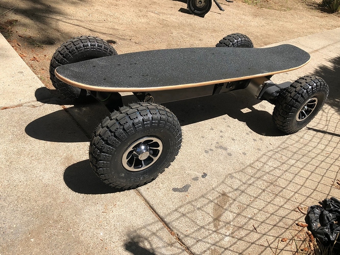

Here is pics of the beginnings.
Ordered a new custom board from subsonic. Changing out support bar from steel to carbon fiber.working on mud guards.That board looks very similar to this one I just picked up.
VERY similar. I like the suspension on yours.Looks good. My suspension is not enclosed and I have dual rear motors. You also have a better remote than I do.
