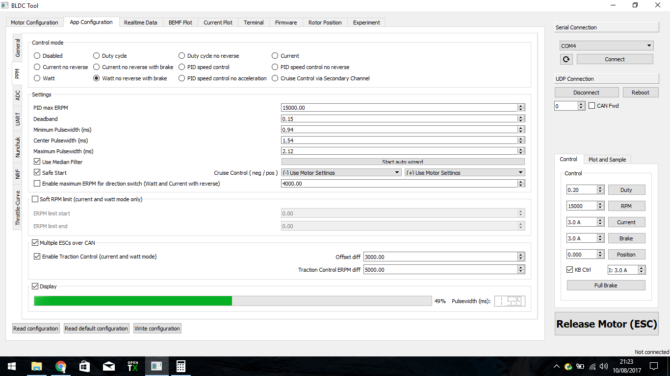

Hi guys sorry for delays for the screen shots work and family any hows here are the screen shots i tried to re calibrate the ppm but still no good tried different settings here and there but no good very strange :confused: cheers guys:slight_smile:
These setting are repeated on the slave VESC .
Just enable in the PPM Tab the checkbox for Enable maximum ERPM for direction switch (…) When you enable that checkbox then to go backwards you have to be slower than this parameter and release the brake and brake again to go backwards. Then the power is limited backwards like it is limited forward. And while you go forward you are able to make a full brake till stand still without the wheels spinning backwards. If you want a bit less acceleration power at low speeds then lower your Motor max (maybe 40 for beginners or less). Motor max is for low speed power (torgue) and battery max (or max watts if enabled) regulates the mid till high speed power.

If you use split cables then it is ok to have the app configuration. But if the VESCs are connected via CAN then diable the app config for the slave.
Wow cheers I do that I have it connect by CAN not from a splitter your firmware is wicked man I have had it running sweet just the reverse power I was little worried about changing stuff cause of it running so good .The app is so handy for checking watts being used and changing modes very cool I’ll post up my results soon as I get chance nice1
