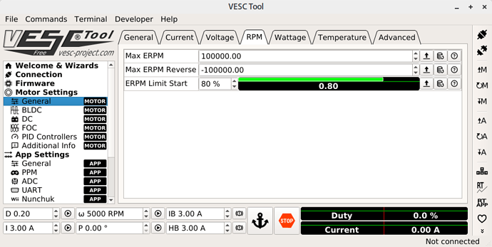

It is possible to set up ERPM max value on the VESC with for example the VESC tool. On this tab you have “MAX ERPM” (also for reverse if you use this, but if you use the current with brake no reverse option, you don’t need to set this.)
It’s also highly recommended to setup the ERPM limit start, this means for example for 80%, that at 80% of the topspeed, your acceleration will decrease. This way you don’t suddenly stop accelerating at your desired speed. I have mine set at 75%. The lower your max speed, the sooner you want to decrease acceleration.

@TehAtheist thanks for the advice, I’ll think about that. The main problem is that I want to keep the 40km/h top speed(that’s the speed at 60K erpm) and by making rpm limit start at 80% means that my top speed will drop by about 5km/h. Also I see in your screenshot that your Max ERPM is 100K. Can the VESC run that high?
@vicciu If you calculate the ERPM for your motors for 40km/h ( with the factors wheel diameter, gear ratio, etc) and set that value, you will reach it. Settings the ERPM limit start will NOT lower it, it just makes the top speed less abrupt.
If you were to try to accelerate at max acceleration from 0 to 60 km/h, with the limit on 40km/h, your board would suddenly stop accelerating at 40km/h and you would be thrown off due to the sudden change in acceleration. If you set the ERPM limit to lets say 80% and to the same test, your board would start to decrease the ACCELERATION (not speed!) at 32 km/h, you will still be going faster and faster, but at a slower rate as if you were releasing the throttle a little. This way, the max speed of 40 km/h will be reached but without the sudden change in acceleration.
The value on my screen of 100000 is the default value I think (My vesc isn’t connected, I just opened the tool to show a screenshot), my board is limited to either 25, 30 or 40 km/h, depending on the profile I set in metr.at (the phone application). So that’s around 36000 I believe, in my case atleast. The default value is that high, just to not use the value, it doesn’t mean that you can reach it without damaging.

Also, uncheck the box that says Limit ERPM with negative torque. If that box is checked, reaching erpm limit will apply brakes on its own. Not good while going fast in the forward direction
