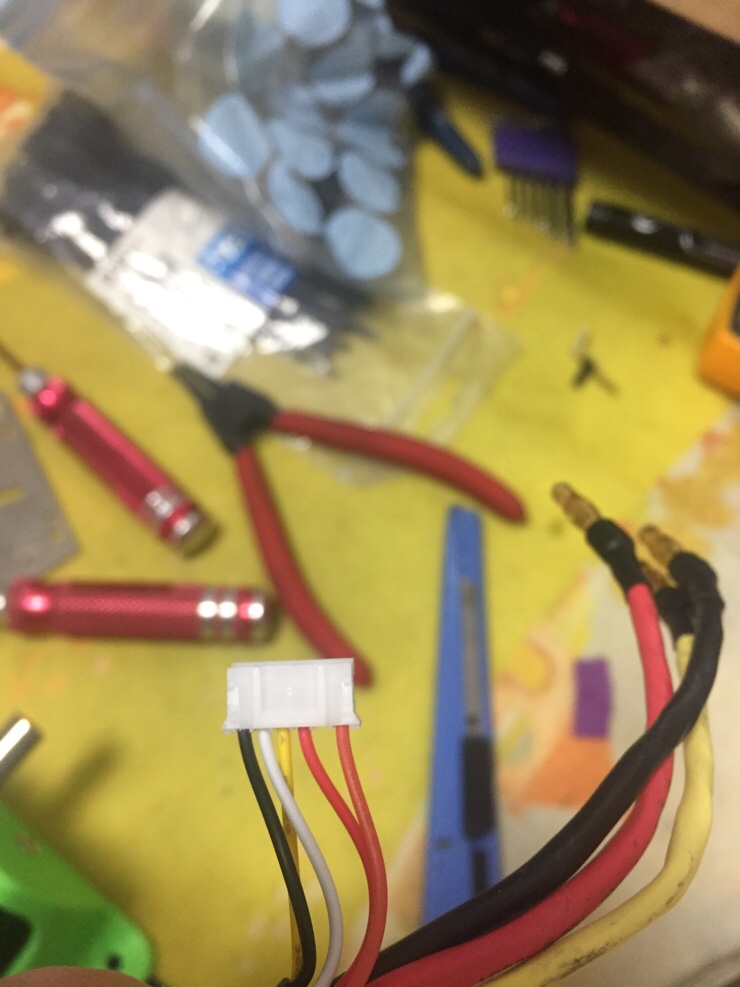

HobbySky 6384 Motor is really attractive price($89). But seller do not provided sensor connector information. So, I have disassembled this motor for get sensor connector pin information.
Black => GND Orange=> +5V
Red, White, Yellow => A/B/C
This motor do not have temp sensor.
AFAIK as long as red and black are in appropriate places, sensor wire dont matter the order. I may be wrong though. So dont quote me
Generally, Red is +5V But Orange is +5V in this motor.
Thx for figuring out and sharing with us! Always good to know
Same difference lol.
