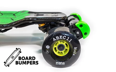

However, I would argue that motors on the outside might be more prone to being knocked/scratched if your skateboard is dropped, falls over, or is rolling around in your car.
This company made a product specifically to address this issue.
