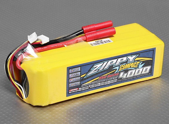

If you are planning to run it with a 6s 10Ah battery then it seems good.
Planning on 10s 10Ah, what do i need to change?
The batteries. From a couple of 6s 5ah batteries you can make 12s 5ah(series) or 6s 10ah(parallel). To build 10s 10ah you need four 5s 5ah batteries or a couple of 5s 10ah.
You can’t make a 10s pack from 6s
Oh yeah I know, im using two 5s batteries to make 10s, but as far as the rest,of the wiring goes would,it work well?
