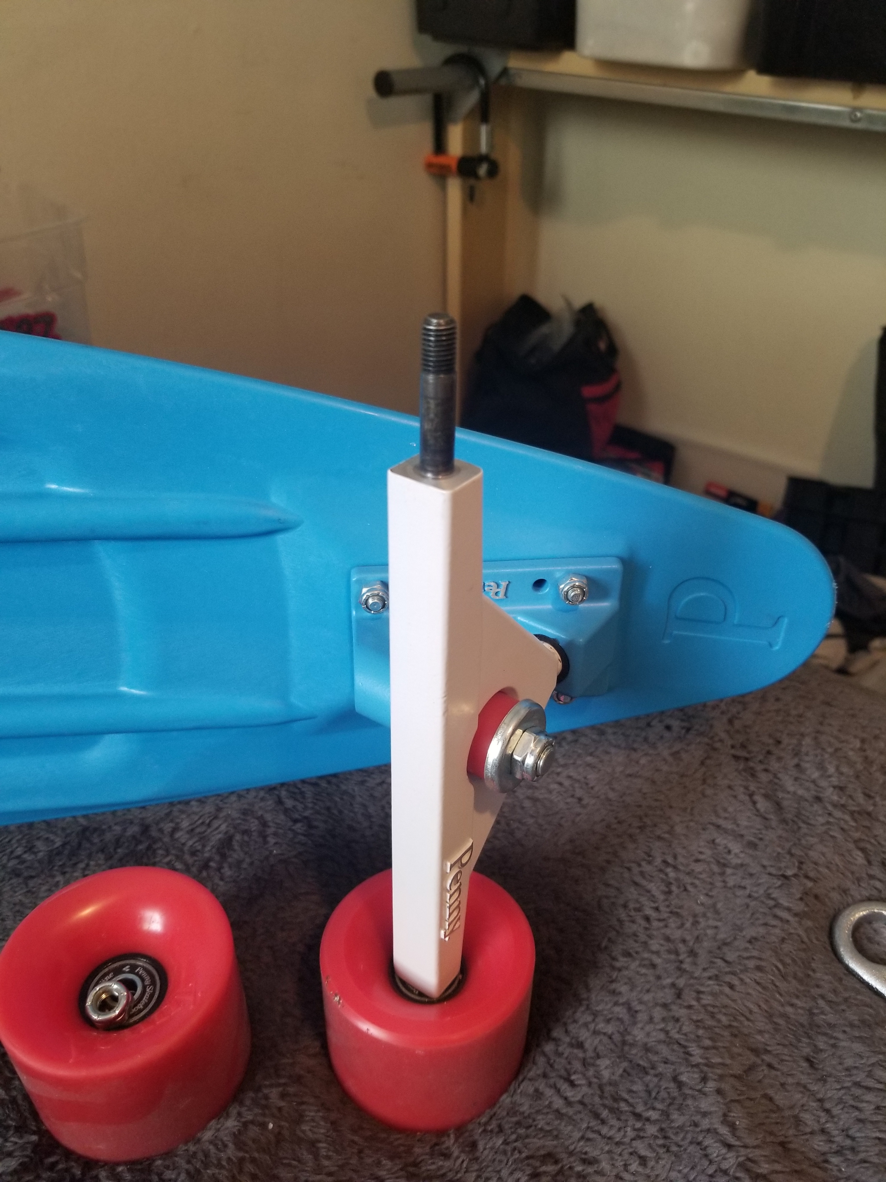

- Hoping to retain stock trucks (i can machine grind etc the trucks down if axles are not long enough- )
- I’m hoping the axles are long enough- they generally go all the way through these days,?)

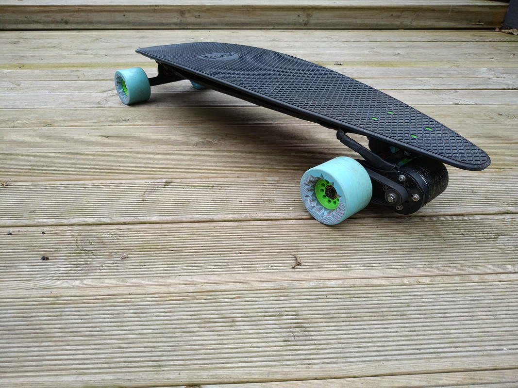

You’re limiting yourself very much by trying to use those trucks. Most hub setups come on trucks already. You can probably keep the front ones you like but back should just be a truck swap.
Sadly there is no plug and play. And small motors are not efficient and don’t have strength to move you uphill.

Unfortunately using hubs means you have to use their less then ideal rear truck or grind the hell out of your truck to fit it. With some grinding, you could fit the maytech hub you posted. It’s not that bad, search YouTube for a video.

I’ve successfully ran belt drive on those trucks, although I’ve since upgraded to calibers
I don’t like the look of belt drive. I don’t understand what part of the trucks are plastic. they are all aluminum
