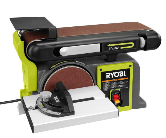

Best type f belt sander:
Might also work but the belt may wear out before you are finished:
Would be very difficult with one of these becasuse you would have no accuracy:
The walls need to be ground very thin.
