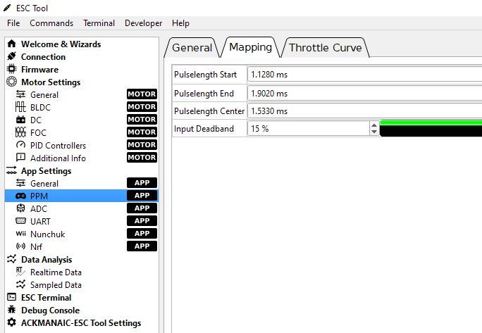

For the VESC programing I used the software by @Ackmaniac. Here are some screenshots of my configuration. Any feedback would be appreciated as I’m still not 100% sure on the settings. One issue I’m having is that the battery percentage varies between the remote, battery indicator and app.
