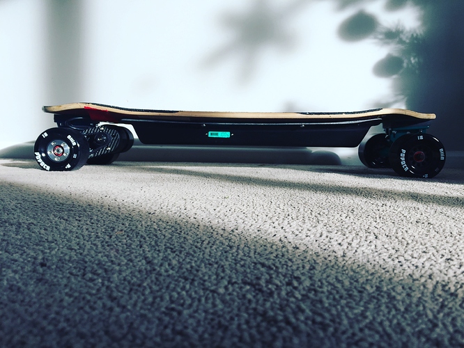

Loaded Truncated Tesseract.
Popocas(90mm) 12mm risers. Calibers.
I’m making a 27mm version of this but fairly specific to these decks.
80a discharge bestech BMS
You can fit a 12s2p, 3p if you stack 3 layers instead of 2 (4.2cm height instead of 3.8cm). Taking into account 17cm of motor clearance you’ve got about 9 in left to play with. You also should have enough room on the sides for cables/connectors etc.
